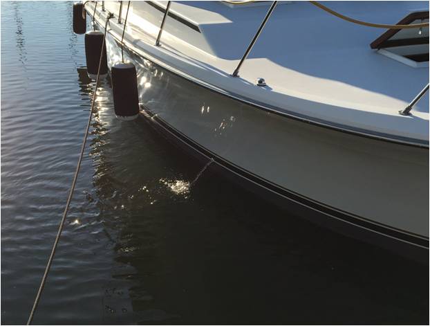

Ok... took way longer than it should have, but it feels good to see the boat finally being able to take a pee again!

I ended up doing a half and half solution - reusing the pump cover and housing from the old pump so I didn't have to disturb any plumbing connections, but the motor and all other guts are new.
The operation of the new pump definitely has a different 'feel' than the old one. With the new one I can easily spin the impeller - you can tell there is something magnetic going on because you feel a bit of resistance, but not much resistance to spinning it and it can spin for a couple of times bit before finally stopping again. The old one felt very chunky - as if the magnetic forces would only let the impeller sit in one of 8-10 positions and it took more force to move it from position to position (if that makes any sense) - trying to spin it you would get at most a half turn out of it...

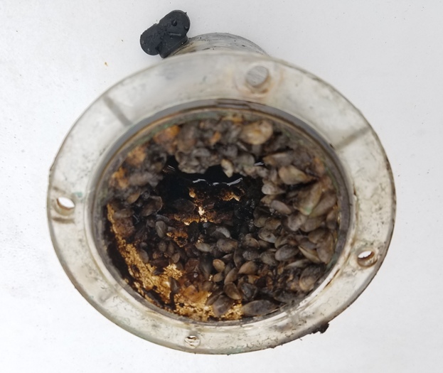

At least you are not dealing with the accelerated growth from our nutrient laden Lake Okeechobee discharges here in Florida. It’s hot and the air is running nonstop, so this is about 2 weeks growth.
