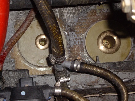

I installed 2 backing plates in the lasarette. Access was ok I guess :shock:

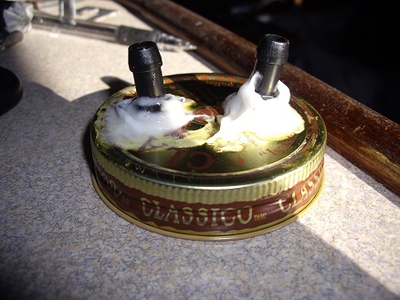

With the leftover epoxy I made this little device...
I'm not saying what it is just yet but I might have to start a new thread on this one...

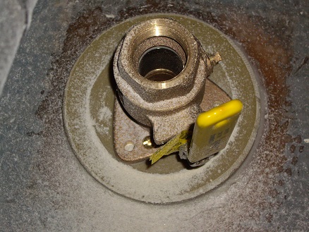

I also did a test fit of the raw water inlet seacock. It is dusty but don't worry, I will clean the area before committing. Now I need to uncover the location of the seacock in the aft head...

I'm guessing your mystery part is the lid to a thumper for moonshine.
It's about time you added that! You'll enjoy the results ;)

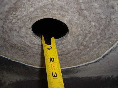

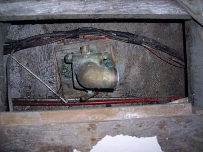

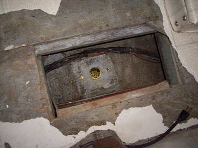

Slow progress today. I now have a full blown cold! :( Anyhow, I managed to clean the oozed epoxy from the holes so that the through hulls go through easy. I also cleaned off the silicon from the bottom ready to accept the new through hulls. I opened the aft head flooring and uncovered the last seacock and removed it. It was closed off but not properly and the floor trap was covered by the glued on flooring. finally there was nothing connected to it... Thank God the PO did not have an emergency!
I also started grinding the hull to patch the holes with fiberglass. The Grinding wheel I purchased yesterday works much better that the regular sandpaper. A lot faster but not fast enough!!! it is taking for ever and the hull is super thick. This hull is indestructible :shock: In this area it is at least 3/4 in thick!

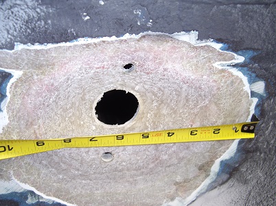

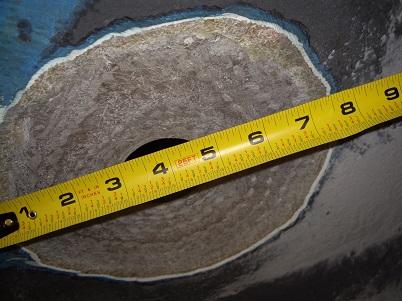

The second one:
I'm thinking I'll grind from the interior as well.
Do you guys think its enough? I could go more...
Tomorrow, I will grind the last one under the head. I actually though I was going to have to replace it but since there was nothing connected to it, I will just block it off. I still wonder what it was for. Any thought?

I think you are doing a great job. when you go to fill the holes, coat the entire area with a thin coat of unthickened epoxy. I always followed that up with a thin skim coat of epoxy mixed with 406 filler (cabosil) and then began my laminating with cloth. I used the thickened epoxy to fill in any irregularities in the substrate allowing better adhesion to the initial layer. i then alternated chopped strand and fiberglass cloth until i had the desired thickness. use a squeege or fiberglass roller to get the air bubbles out

Much appreciated. Wait until I do the glass! You'll see what the doohickey I made with the leftovers is for... :D

Maybe I spoke too much Todd! Barrie might catch on to the use of my gadget... :lol:

be careful to seal the hole with tape from the opposite side before you use your vacuum doohickey

My interest is peaked, I was going to guess that it was a lid to a mason jar bong, but i'm thinking now it has something to do with glassing in the holes??
