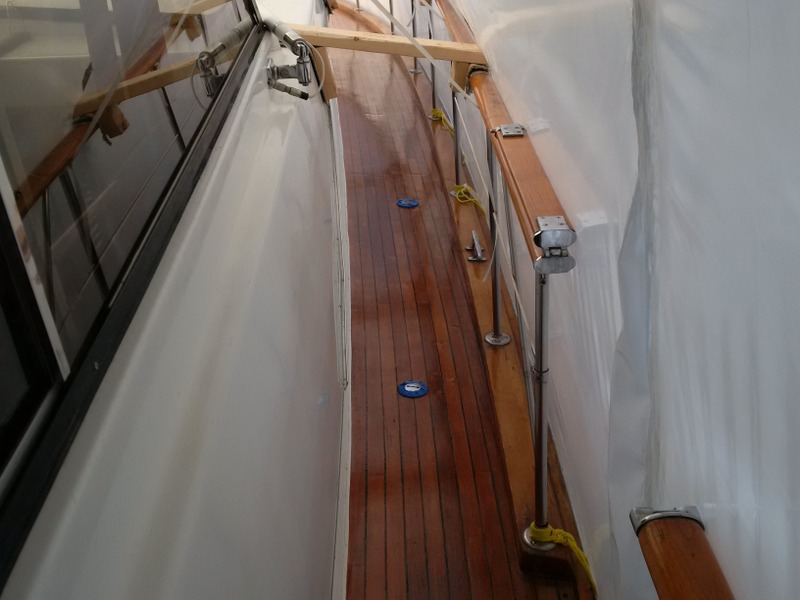

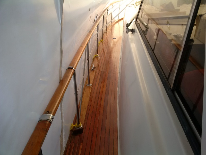

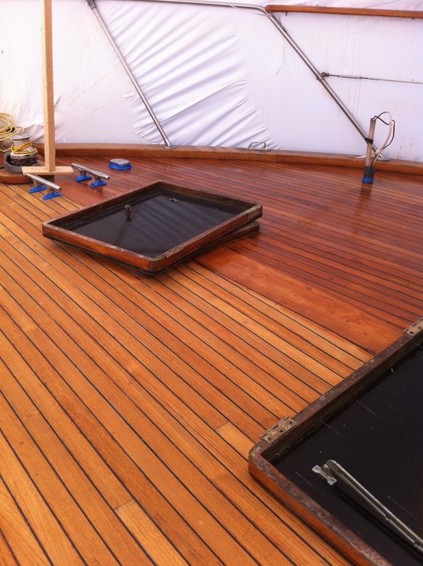

Well, I can't say that I wasn't warned........ in spite of Cetol Marine Light claiming to be natural colour, my decks came out waaay orangier than I would have liked. In the picture, the port foredeck is sanded bare and all I wanted was a clear coat on that colour. What I got is on the starboard foredeck.
The toe rail along the side is the original colour which was what I was hoping for. However, so far, I'm the only one that expressed disappointment. Everyone else says it looks fabulous....... and I am extremely happy with it compared to last year. Oddly enough, it's the exact same colour as the aft salon, and I never thought that it was orange at all, so I'm hoping its got something to do with the bright white shrinkwrap.
We'll see what removing the bright while shrinkwrap and some sunshine will do over the summer.
Thanks again for all the input.
Ron
