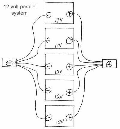

Post by jwrape »
I was goggling parallel battery wiring and of course there is a ton of stuff about wiring batteries in a off grid home for inverters.
There was a couple different ways they suggested wiring the batteries for optimum performance.
The first way is the normal way everyone would think, just running positive to negative and then pulling off the top battery.
Then there is wiring them positve to positve and Negative to Negative but taking the positive from the top battery and the negative from the bottom battery to balance the draw off the batteries so that the top battery in the above picture doesn't do most of the work and the bottom battery doesn't do the least work
Then there is the best suggested way and that is to bring all the postives and all the negatives to a common bus and pull directly from the bus. That way all the capacity is used equally. Also charges equally.
From what I can tell, options 2 and 3 are almost the same principal but by far the 3rd option would be ideal.
What do you guys think
79' Carver 28' Mariner
