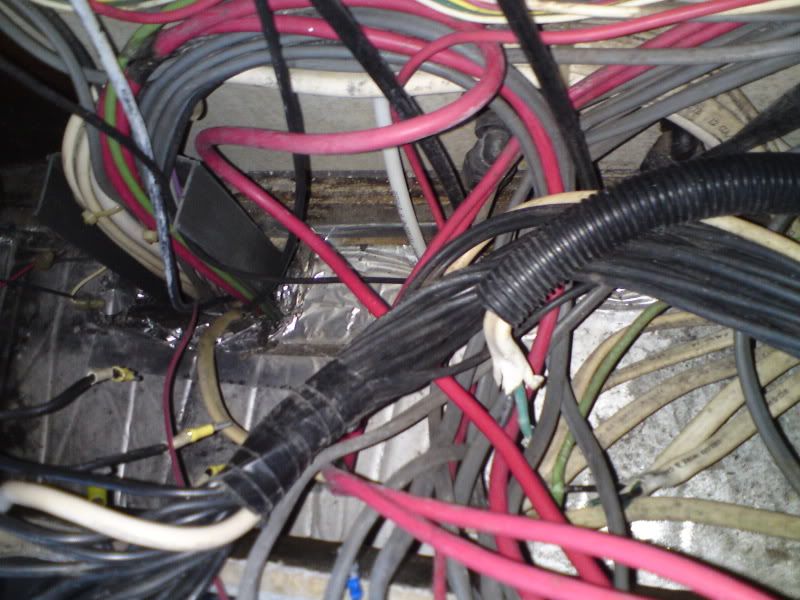

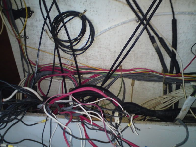

How about the snakes nest...... There is a lot of wires in there! This is from behind the switch panel.
pk
Posts: 441
Location: Moss, Norway
Post by pk »

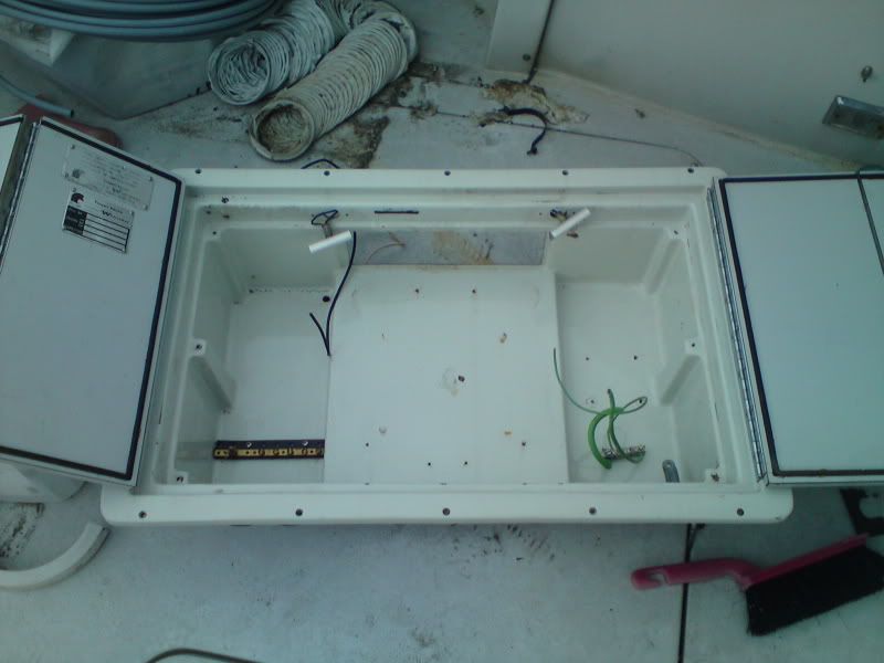

Most of those wires will be taken away. From the engine room it will only be wiring for the engines, from the battery bank, bilge pumps, and the 230Volt battery charger. Rest of the wires will be taken from the compartment behind switch panel, via a new panel and to the spasific places where DC is needed. Like interior lights, fridge, stereo, waterpumps, and other things. In the place where AC used to be I will put in a heater system for blowing warm air into the cabin ( we are in arctic climate). I guess I will have lot to do the next week.....or two.
rbcool
Posts: 938
Location: Kent Island, MD
Post by rbcool »
We call that a "Spiders Web" :lol:
Looks like your making progress, keep the pics coming :wink:
Ron 8)

wowzer52
Posts: 959
Location: Longview, Wa.
Post by wowzer52 »
I sure hope you can put all that back together again, that is a big job. keep us posted.
1975 F-32 "SIMPLY BLESSED"

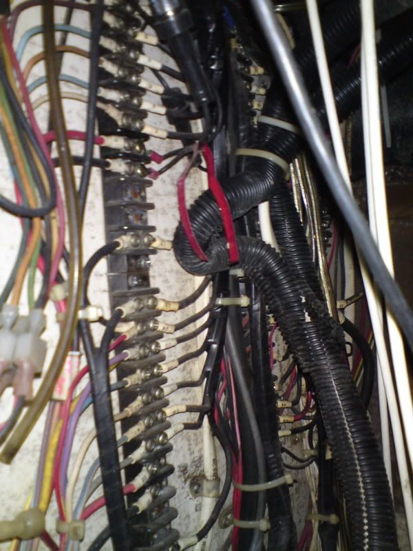

the factory wiring system on the Internationals was well done and received good reviews.
generally speaking these systems have held up well over the years,
be careful not to re-do what may in fact be quite functional.
that big bus bar in the photo is a connecting point where for the most part the dash module is "plugged in" to the rest of the harness.
i strongly suggest that you keep that bus bar and attach your new dash to that point. Otherwise you will certainly have your own NEW snakes nest.

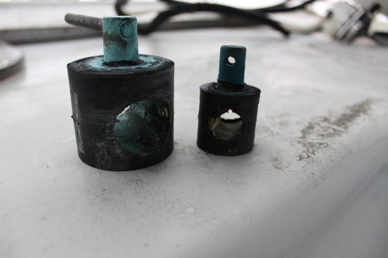

Just a small update from Norway: Today the weather was allright. I have done a lot of work in the Trojan. Work like emptying the engine room for old and useless wires, and taking apart the seacocks / valves. Their brand is Groco, a brand there is not in Europe. At least not for valves. Th shopguy wanted to sell another brand to me, but no. I don´t want that crap. So I decided to renew the old seacocks And it seems to be easy.
The interior of two of the valves. Just give them a quick clean in a solvent for rubber. Use a sanding paper for all the metal parts. You don´t need to disasembly the whole seacock, just take the rubbervalve out. When assembly again, be sure to put in some Vaseline white grease, just for the rubber to stay soft. More pics will follow tomorrow.
