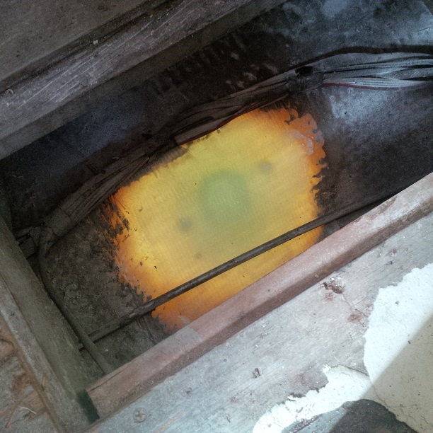

2 weeks later, I am back, remove the glass and start over. this time I get smart! I check the weather, It nice and cool, no storms on the horizon and I pre-saturate the patches before applying to the boat. This time I got plenty of time to do everything no problem. I unfortunately did not have time to take pictures nor did I use my fancy vacuum bagging system... I did complete all 3 holes. 8)
Here is a picture of the aft head condemned through hull hole...

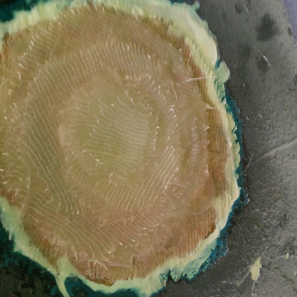

Now for the outside.
All I need to do now is clean it a bit and fill to make it nice and flush with the hull.

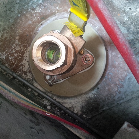

the next day I tackle the 9 seacocks. I came up with a pretty efficient method to do this alone. I chamfered all the bolt holes on the seacocks from the underside (side that will sit on the hull) to help make a seal. I measured and dry fit all the through hulls. Then, I put the sealer on the base of the seacocks, slide in the 3 bolts in the flange and drop the seacock in place. I go outside, install the through hull just snug. I push in fresh bolts from the outside making sure there is sealer on them (this pushes out the bolts previously inserted from inside) and tighten the through hull properly. I then go back inside and torque the nuts with a torque wrench. Tightening the through hull before, made the flange of the seacock turn just a bit and pinch the bolts preventing them from turning while torqueing. That's it. Pretty simple! I was able to do 2 seacocks at a time using this method.
I am really happy with the results. looks clean and professional. IMHO...
