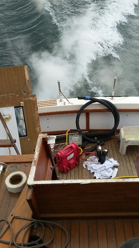

Yes, the 440's I used to repower my F36 came with closed cooling so, a single pump for the manifolds, heat exchangers and oil coolers. (November sea trial photo)Those duel pocket Sherwood's pump lots of water. I came across some extra parts for them that you can probably use. Send me your mailing address and I will send them to you. Jim.
