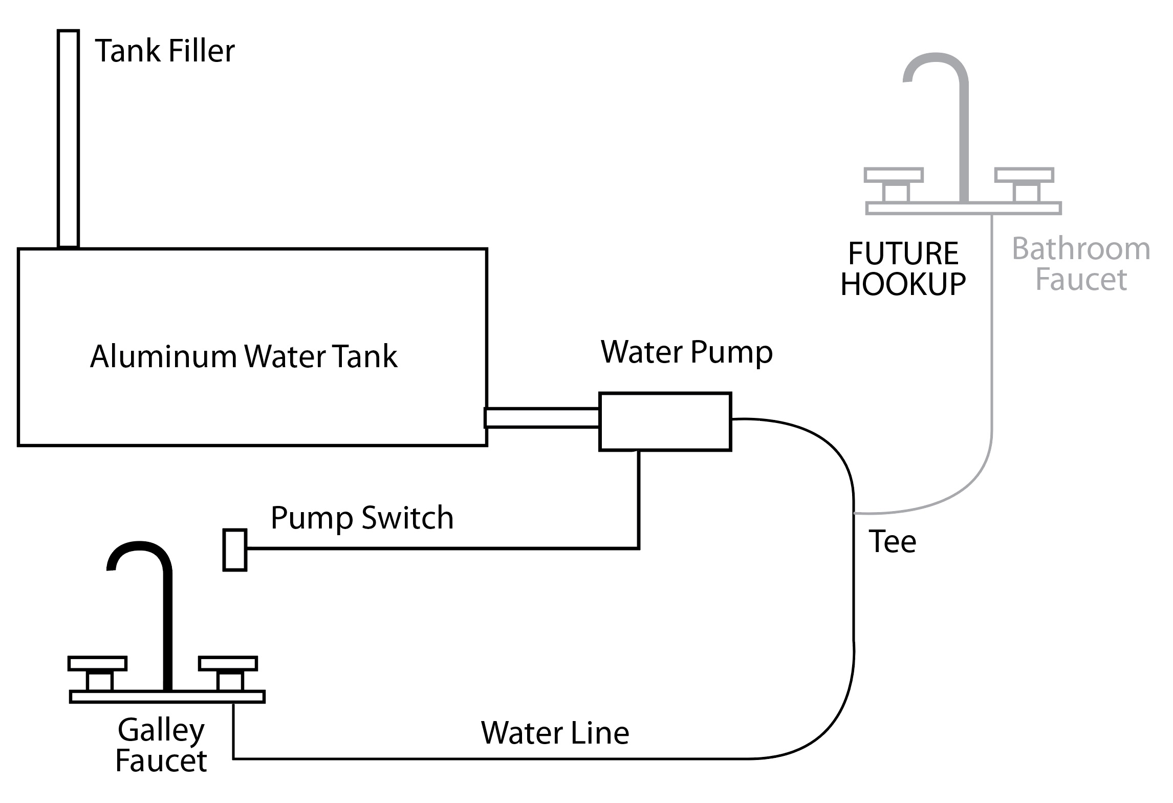

I have a 1977 Trojan F30 Express, and have some question on normal operations, and possible upgrades.
Here is the situation I have now. I installed a new faucet in galley, and ran a new water line directly from 12V pump which is located right next to large aluminum water tank. To run faucet, I must turn on an electric switch located near galley faucet. New faucet works great, with REALLY strong flow. This is due to a much shorter run of tubing, and a slightly larger tubing diameter.
Here are some questions.
1) if i leave pump switch on and turn off faucet, the pump pulsates, and makes noise, and does not seem happy. Is it normal on my vintage boat to always use switch for water, and only have it on when ready to turn on faucet?
2) is there an alternative set up that would eliminate the switch, and have the faucet work like in a home?
3) my tank being 40 years old, is there a good way to flush it, clean it?
4) now lets say i want to plumb up my bathroom faucet. do i have to go to the galley to turn on pump for water to flow in bathroom? would I hook up another switch in bathroom, and how would this be wired? (and same issue if i want to add a deck hose outlet to washing off deck or after swimming.)
In summary, what is the slickest, cleanest way to set up my water needs on a 1977 vintage Trojan 30 footer ;-)

What kind of pump is it? Most freshwater pumps have a pressure switch mounted on them that automatically turns them off when the correct pressure is reached. It sounds to me like your pump is not turning off at all, which likely means a bad pressure switch. Also, your diagram is not showing a pressure accumulator tank, do you have one? With an accumulator tank and properly functioning pressure switch, you can leave the pump on at all times and it will operate just like at home.

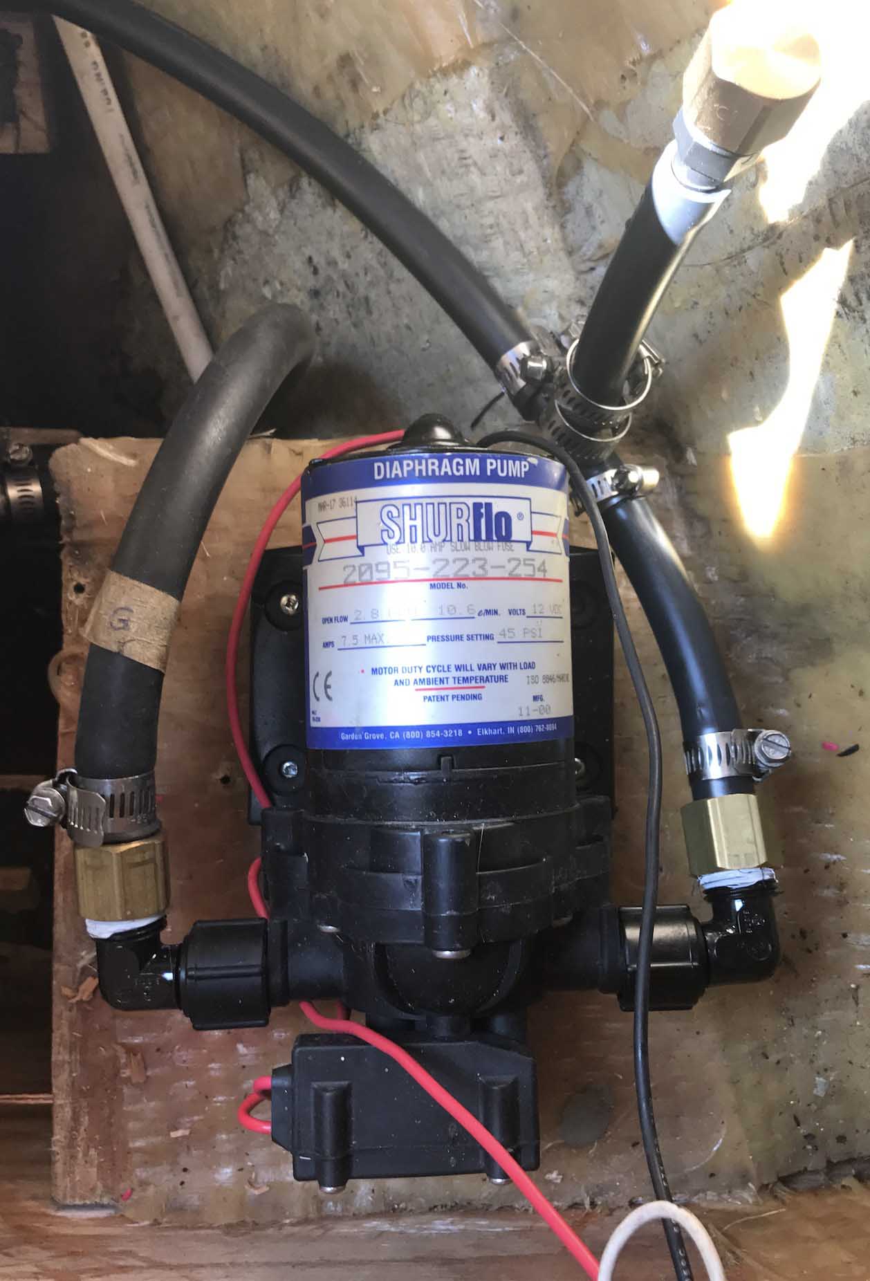

great ideas and help... thanks! Attached is a picture of my pump. It looks like it has pressure switch on one end?!
this pump looks to me made in 2000, so it is not original by a long shot.

@ Liberdade: I think you were right... I had a slight leak in fittings that was letting air and water in/out. Once I tightened everything up , it worked like you said... turn on switch and leave it on. Thanks for your guys help!!

Your water set up is identical to mine and I also have an aluminum tank. That upright contraption looks like a winterizing device jerry rig. I would remove it.
The pump may nearing its end of useful life. Once the switch on galley is pulled, pump comes on pulsates and then shuts off.
Like others said, if it don’t shut off, that is an indication of a water or air leak.
I would not add an accumulator tank. Or system is small and new pumps have more power.
So water comes from water pump to dinette and then splits with one going to hot water tank and remaining cold going and splitting again to go to each faucet.
