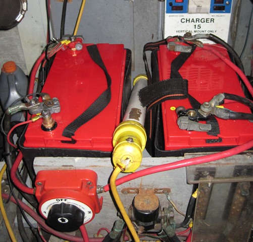

Did the F36 come with a battery switch? Ours has a Off-1-2-Both switch near the batteries, but I cannot find any reference to it in the wiring diagrams.
Here is an old photo from the survey:

Re: F36 Battery Switch
My tricab has no switch. Still doesn't, but I did add blue sea battery terminal fuses. Put them on your Christmas list!
Thanks for the support with Santa! I already have the crimpers, but have not yet sourced any terminals, HW or wire.
My batteries have weird terminals. They are brass terminals with M8 studs into a threaded connection on the battery. I broke one earlier in the summer while on vacation and was unable to find any parts to replace it while travelling, so I stole a terminal off the generator battery. Rolls tech support sent me a replacement terminal once I got home, which was very nice of them considering that the previous owner of our boat bought the batteries!
