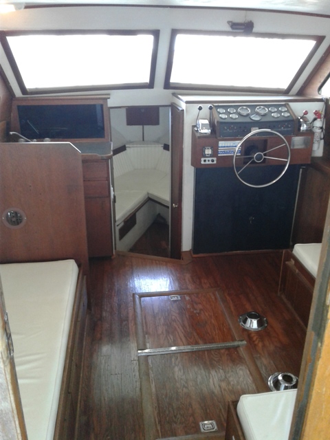

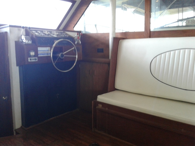

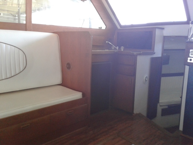

Can someone tell me what type of wood was used in the interior? Also, what refinishing products do you recommend? MIne is in decent condition but very coarse and dull. Attached are some pictures for reference. Thanks in advance for any comments.

Very nice! Think you will see some teak, laminates, and vinyl. You might use some Murphy's cleaner, then follow up with some Weiman furniture cream or just lemon oil. See what you have before anything serious in the way of refinishing.

In my previous Trojan which was a '74 TriCabin, I had teak laminate with teak trim in the interior walls. I always sanded it right down to the bare wood and then put on three or four coats of plain marine cetol (never gloss.)
Make sure its marine and not cetol from a lumber store as the flash point (how quickly it dries) is slower and you will not almost poison yourself with the fumes like I came close to doing (ended up in the hospital overnight).
We were always very pleased with the cetol finish on the Trojan teak.
Your floor though might appear to have some grain in it that I didn't have in my Tricabin cockpit floor (which was also teak)..... so wondering if previous owner might have installed oak... thoughts?

Thanks guys for the replies. I do believe the floor was done by a previous owner. It looks like oak wood flooring from the grain, and is in pretty good shape. I think most of the paneling is a veneer but I am not familiar enough with teak to make that assumption. From ya'lls replies it sounds like that may very well be teak. The solid trim pieces around the door jams and windows are probably teak too I assume. I have some Murphy's and I'll give that a try in a few spots to see how it looks. Thanks again for your replies!

Just to confuse you more, you may have a mix of teak and mahogany all stained to match. There's probably some teak trim but the solid wood structural framing, cabinetry, etc. are likely mahogany as well as most if not all of the plywood to reduce production costs. The teak will have a tighter more dense grain than the mahogany. Older mahogany won't have as much of a wavy grain as the more recent stuff but it'll be wavier than the teak.
I find using oils are okay as long as the current wood tone/surface, and finish is consistent and not blotchy. To get it to that point, it's likely you'll have to do a lot of prep, and I find it's good to have a really good base or rubbing oils disappear fairly quickly. With very little prep, an even coat of regular/flat Cetol is easy to apply and will probably even out all the different tones you may have going on from faded finishes. Given that it's interior surfaces, a Cetol finish will likely last for several years if done right.
