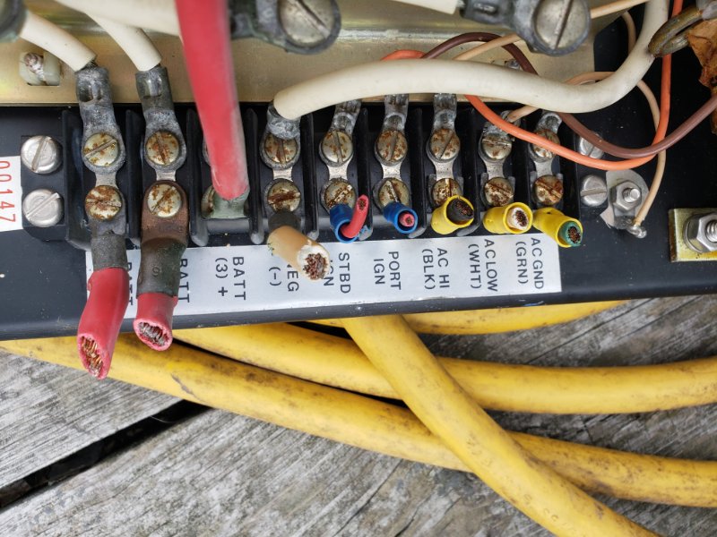

Installed a new smart charger this weekend, original finally crocked. While removing old noticed ignition wires to terminals for port and starboard, labeled wires and abandoned. When I flip the toggle switch at the helm alarm sounds but nothing happens when I press the start button. Should these wires now go directly to their respected batteries with an inline fuse? If not where should they go?

I have the batteries wired from charger. Where to the ignition wires go now? There are no terminals for them on new charger.

You normaly do not hook up ignition wires to the charger . Can you post photo of the old charge and maybe the wires ?

When I removed my original Trojan charger I found wires running from the ignition to the charger. These wires are to turn off the charger when you turn on the ignition. I have since replaced the charger with one that has more smarts the pro sport from pro mariner. I have the 20a 3 battery charger.

horhay1946 wrote: ↑Thu Sep 20, 2018 5:29 pm When I removed my original Trojan charger I found wires running from the ignition to the charger. These wires are to turn off the charger when you turn on the ignition. I have since replaced the charger with one that has more smarts the pro sport from pro mariner. I have the 20a 3 battery charger.
That would make sense I still have never seen it . Do you remember the brand ? If that was the case you would not want to hook these wires up .

What did you do with the ignition wires after changing out the charger? I just installed the same pro smart. Boat will not turn over just get the alarms.

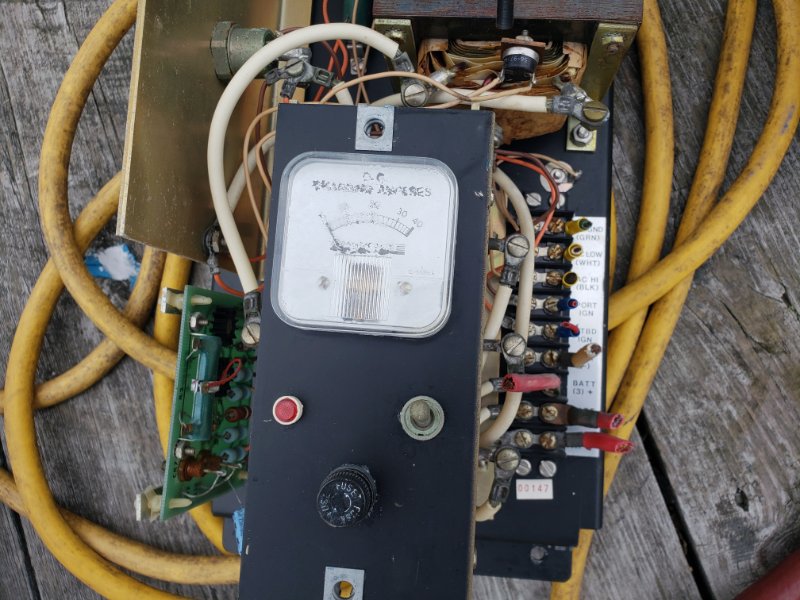

I believe you are correct about ignition wires killing charger, I traced where they went in old charger and they went to a circuit board only.

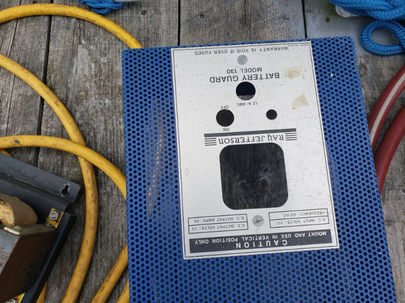

Prowlersfish,
Here are the pics. Any ideas?
