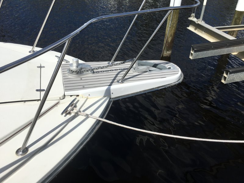

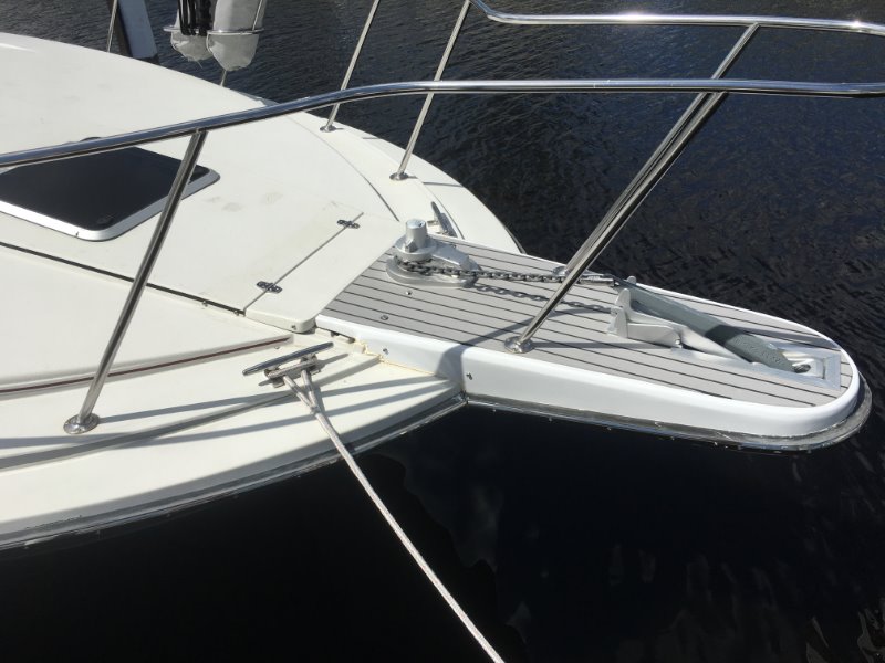

I added a Lewmar Freelall 600 in 2001, 17 years ago to my 10 meter
it was adequate at best
deploying was always perfect
lots of issues with the clutch and gypsy on retrieve
difficulties in getting the clutch to engage, and the gypsy would occasionally spin on the rode
despite mounting it as far aft as possible, its design allowed it to dump the rode too fat forward in the anchor locker, where it would ball up at times during retrieve.

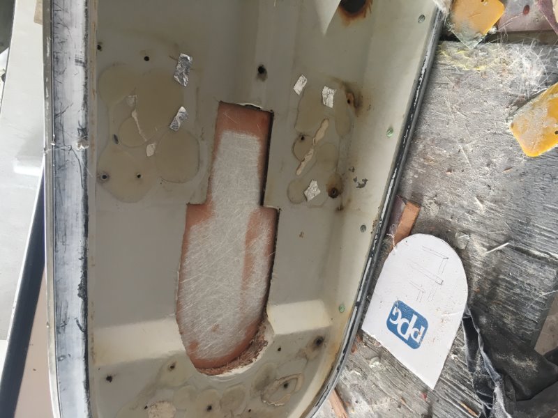

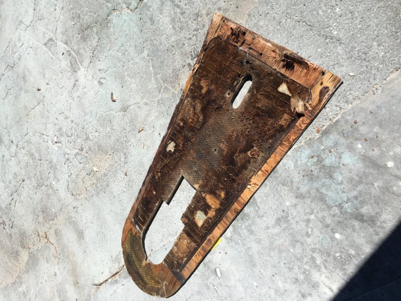

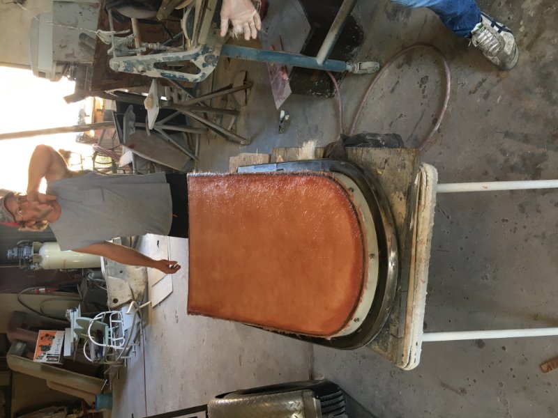

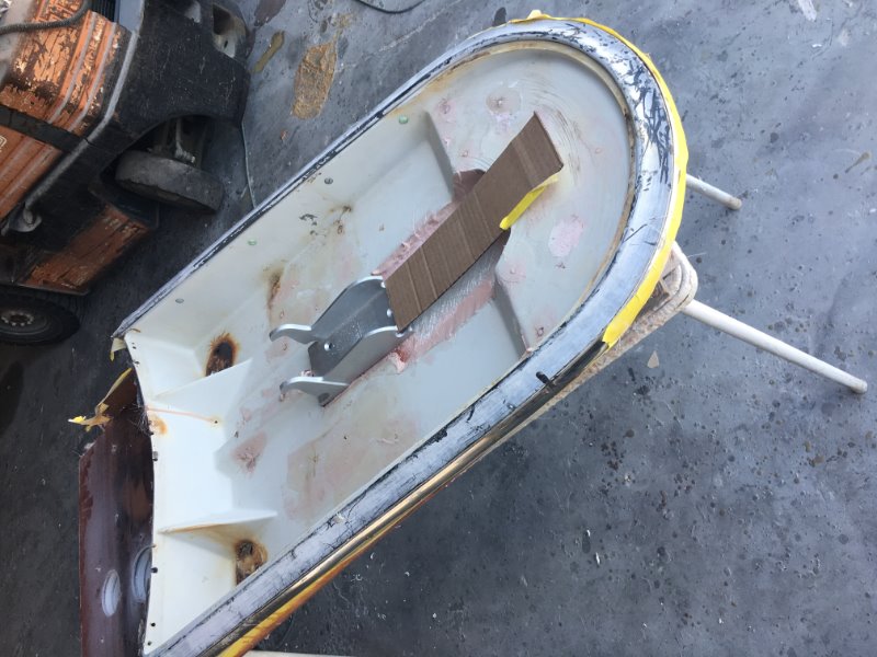

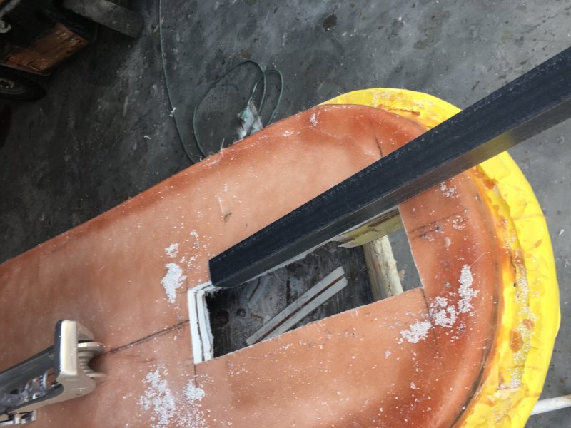

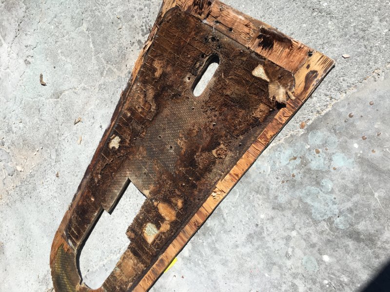

During this years refitment, while I was replacing the water soaked balsa, I upgraded to the GOOD freefall windlass.
I will ATTEMPT to post some photos.
Meanwhile, DO YOUR RESEARCH before selecting a windlass AND DON'T UNDERESTIMATE OR SKIMP ON THE WIRE SIZE

Re: Windlass for 10 meter
more photos here:

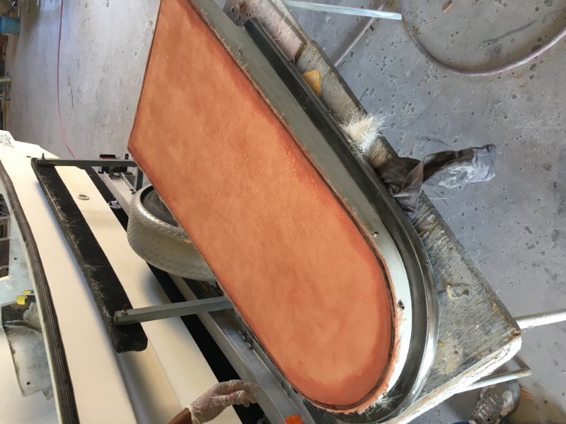

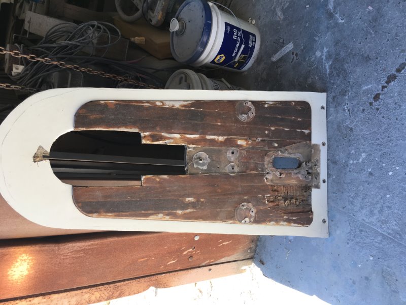

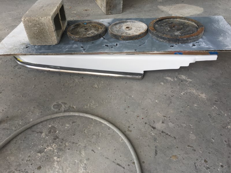

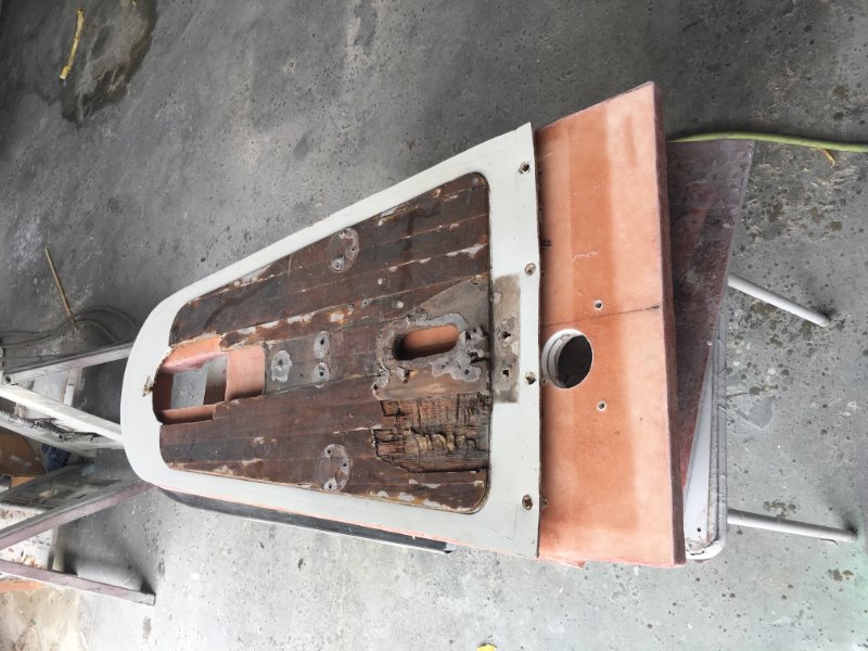

and a few more:

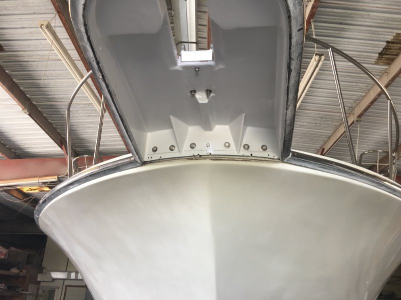

It should be noted that we extended the bow pulpit a bit to the rear, shortening the door to the rode locker.
This was done to INSURE that the rode would be dumped as close as we could get to the deepest part of the locker
I'll get some finished photos taken this weekend and will post

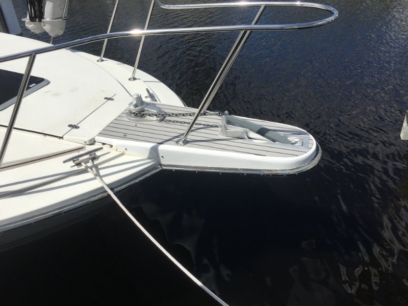

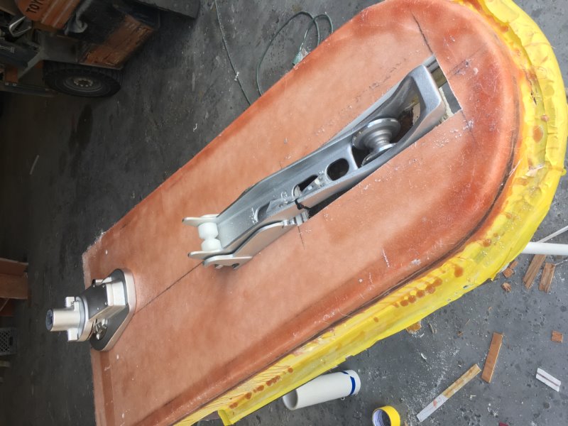

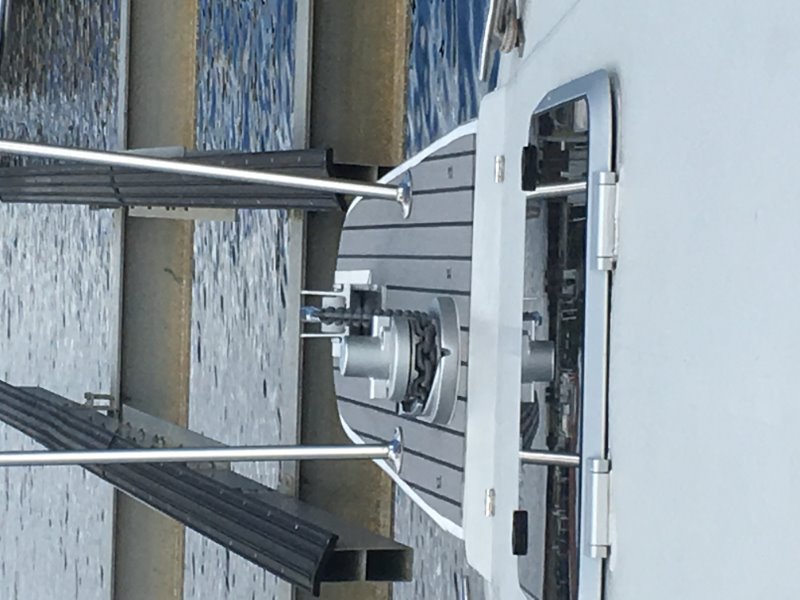

additional photos

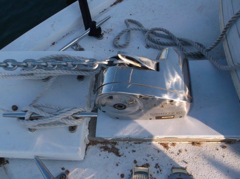

Very nice . I really like that Good rode/chain windlass . I had a Good rope only that worked great at 38 years old . But I wanted to also use chain . So I went with a Lemar pro 1000 due to cost . It was not a free fall but the price was right and you can convert it to free fall ( the pro fish is) . Well the power down is so fast , I have no plans to do so , in fact is seems faster then the free fall I had . I am very happy with it . With that said The Good is a better Windlass and I would have gone with it but the price was right on this one . one year old .

Another vote for the Good. I installed the same one as RWS, even the same bow roller, worked flawlessly, nice equipment, quality parts, very nice family business to buy from and made in the US. Would not hesitate to buy again.

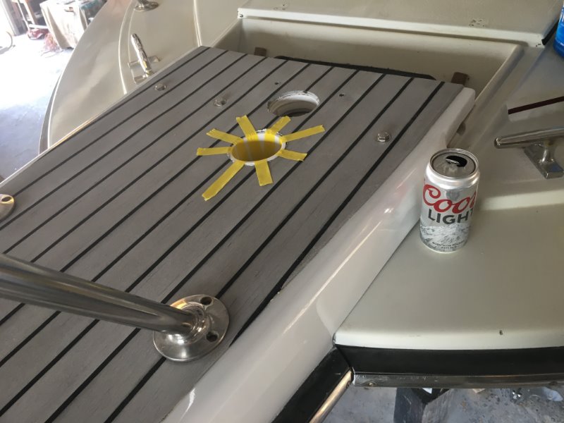

I just put in a Good F850, see my posting under "12 Meter Pulpit" Tom Ring and his son were always available to answer any questions.
Installation was easy. 4 holes for studs and two 3-1/8 holes, one for motor one for rope/chain. And it's low profile.
