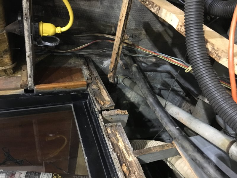

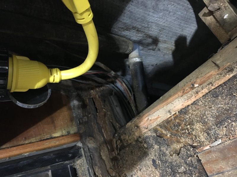

I though it would be good to share the progress of the refitting of my new to me 1976 F-32. I started gutting the cockpit deck and it has the typical rot on the perimeter framing

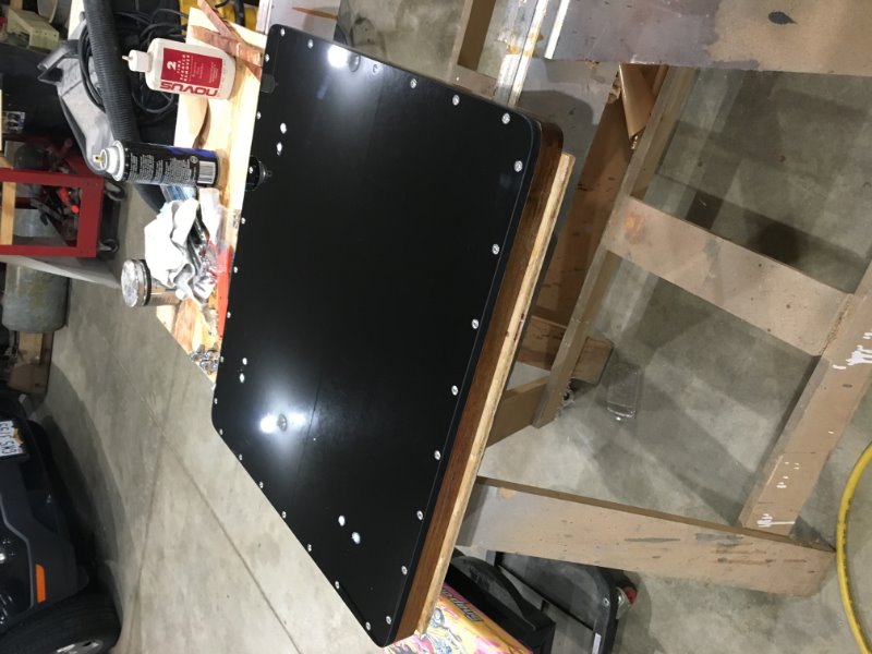

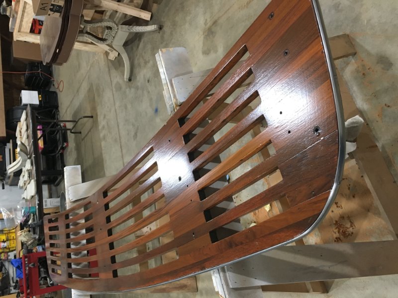

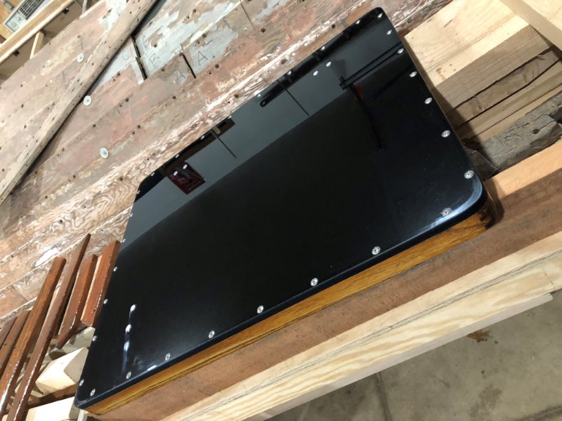

Also been working on refinishing the swim Deck and I updated the plex hatch covers with new plexi.

Wow. Looks amazing. Is that the original swim platform or did you build it?

That is the original swim platform. I'm adding a ladder and will post pics when it's done.

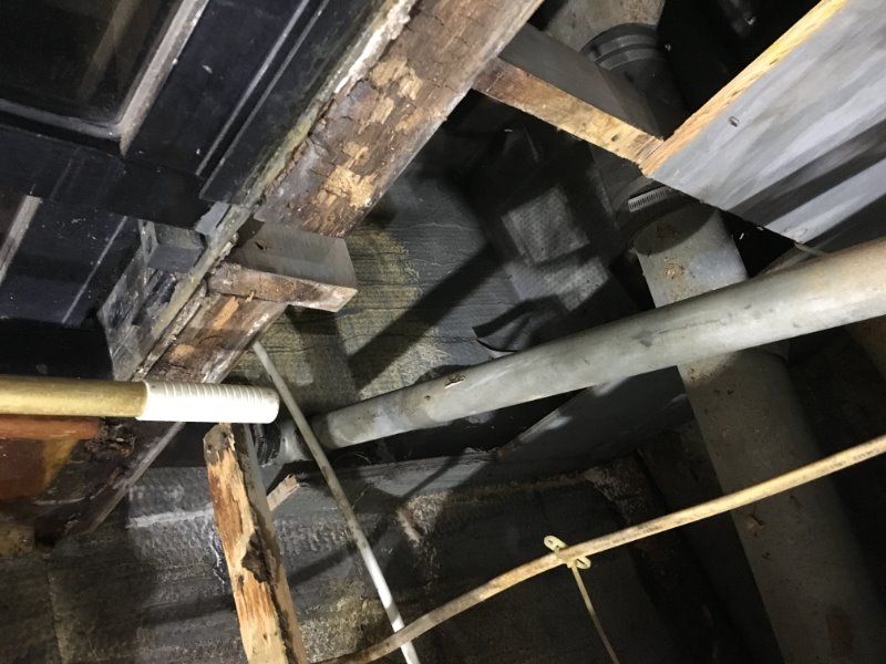

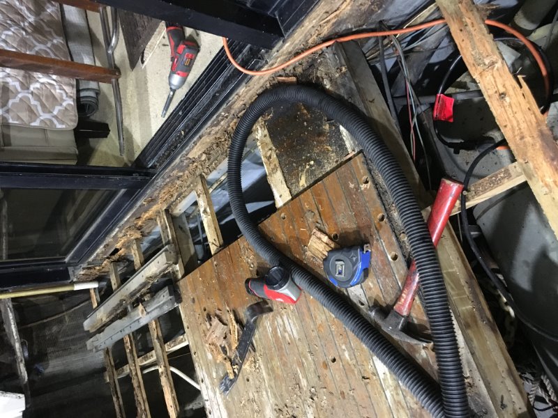

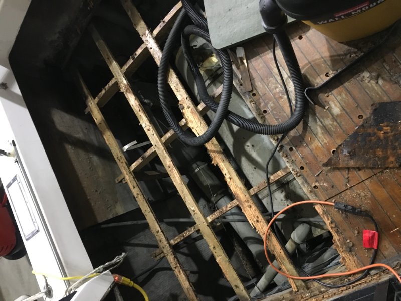

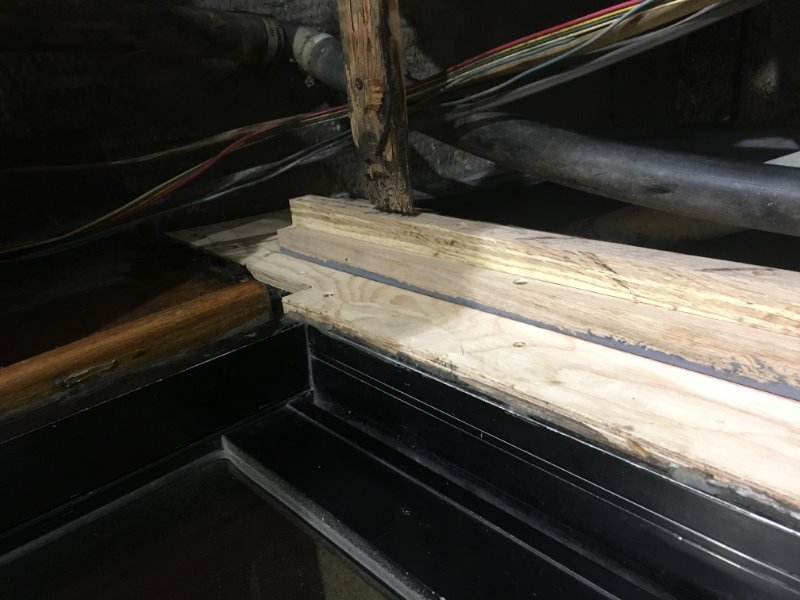

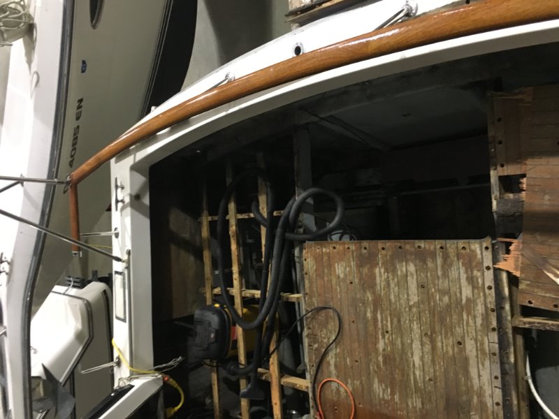

All the old decking is out and now its time to replace the top of the bulk head and rotted framing. Has anyone replaced the celotex lik material Trojan used between the stringers and under the plywood? I'm thinking some type of foam board would work good.

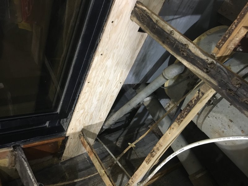

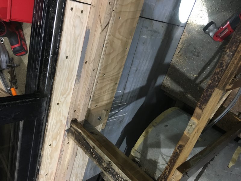

Bulkhead is cut out and the new parts are made. Finally going to start putting things back together this weekend. Replacing all the rotted White Oak below the Sliding Door/Salon Deck. And all silicon bronze fasteners. Once its in I'm going to redo the fiberglass tabbing on both sides of the new bulkhead. Plan on using epoxy resin and 24 oz woven roving cloth. Then everything is getting a fresh coat of paint.

Had a productive day today. As always I didn't get done what I hoped to but still made good head way. I have the new bulkhead done under the sliding doors. Everything lined up nice and straight too. I used hot dipped galvanized carriage bolts to make it better than the factory. All I need to do is glass the tabs on both sides and then paint both sides of the bulkhead to finish. I also patched in the port side vent box where it had rotted out by the transom. I used thickened epoxy to glue the old tab to the new plywood. I scuffed the back of the tab with heavy grit sandpaper to make a good bond. Now I can finish the framing the pattern the deck pieces so I can build the deck at home. Sorry about the side ways pictures I can't figure out how to make the load right.
