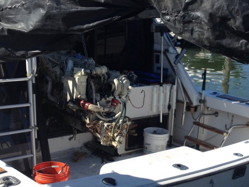

There's also this approach to pulling an engine..... but I can't say I recommend it!
- Posts: 12723
Re: F32 patio glass removal
Ouch . Believe it or not that the way its done on some boats , Seen some tugs done that way .
