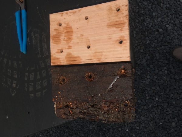

Re: Prop strut backing plates
Update for anyone needing to do the same on their F32, without removing the floor/tanks.
With the help of a friend and a Home Depot/lunch run, it took about 6hrs to replace both.
Things to note:
1/4 tank of fuel in both.
The aft freshwater tank in between fuel tanks must be removed.
In order to raise the tanks to gain access, I obviously removed tank straps. Removed aft wooden tank braces. I drilled 1/2” holes on each floor joist that were above the tanks, and inserted a 1/2”x10” carriage bolt. From there, I attached a ratchet strap end to each bolt and placed the strap under the tank (aft side). Crank away—the tank will raise like magic. There, you’ll have more than enough room to do what you need to do.
1 of 12 bolts came out in 1 piece.
Used 1 full-size tube of 5200
Sore back/hands/knees are currently setting in
Things to note:
- 2D51DC3A-3A10-4635-AB88-DA0B72C4AF36.jpeg (103.96 KiB) Viewed 10144 times
