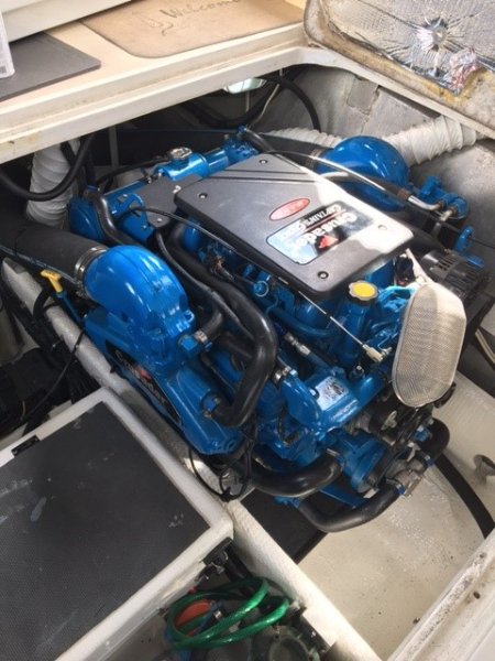

port 8.1 10m mid cabin.jpg (63.41 KiB) Viewed 15337 times
8.1_cyl after 3.5 hours of break in.JPG (75.26 KiB) Viewed 15337 times
Here are a couple of pics. The top one just showing the portside installed. The 8.1's are a perfect fit from a mounting perspective with two exceptions.
1) The original engine mounting brackets were at an angle for the old 454's. With the 8.1's and a down angle transmission, they need to be level. Once removed, I upgraded the size and thickness of the galvanized backing plates (what mounts each bracket to the stringer) and was able to inject thinned epoxy into each bolt hole. I also added a 1/2" aluminum "shim" the size of the bracket on one side of each engine. I did that because the factory setup was a little wide and exceeded the Crusader spec for the trunnion overhang. On my port side in particular, there wasn't much of the trunnion extending into the mount so this tightened it up and within spec.
2) Figuring out where the brackets should be was a huge challenge, this was like building a boat from scratch in some ways. The engine and transmission were going to be at a different angle and location front to back. How do you figure that out? I toyed with the idea of getting a plastic engine block which I would have done but they're $1,000+ and something I would literally use once. Someone should come up with a rental for these, I'm sure guys restoring cars would rent them all day long. I was at a loss and then had an epiphany after about 4 Coronas staring into the bilge.
How about remove the transmission and bring it to the boat? They only weight about 100 lbs (aluminum case) so this was feasible. I'll let the transmission dictate where the engine should wind up. I should add that I had a bushing made which kept the shaft perfectly centered in the shaft log the whole time. So, that point is fixed - good. Now, get the transmission coupler and shaft coupler eyeball close and let the engine fall where it wants to. I knew it wouldn't be perfect so I made a bunch of mount shims of varying thickness. My goal was to get the mounts roughly at the 1/2 point and THEN start the alignment. Getting the transmission into place was painstaking.
What I wound up doing was using blocks of wood under the transmission to determine where the mounting brackets should be on the stringer. I tacked the brackets into the stringer with sheetrock screws and moved up/down back and forth probably 40 times. Once I got those two couplers basically facing each other, verified that the trans wasn't bottomed out on the hull, etc., then I made the install of the brackets permanent (level side to side across and front to back). Once I was positive that the transmission would line up, I new the engine would as well. The transmission is the low point to the hull so the engine oil pan clearance was a non issue. One unexpected plus, I can now stand in front of the engines for any maintenance. The crank mounted pumps will be nice. The Sherwood E35's are a PIA on the 454's, both changing the impellors and adjusting the belts.
Finally, that second pic is one of the cylinders after 3.5 hours of break in running. Definitely showing some signs of oil but I'm reading that's actually a good thing that the break in is taking place. The cylinders walls don't look like there is any glazing which apparently there is no undoing if that happens.
