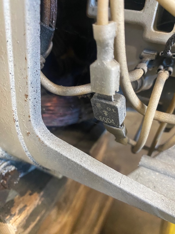

Onan MCCK charging diode
- Beacon Bob
- Posts: 275
- Location: Easton, PA
Important information for those of you who have a Onan MCCK gas generator.
If you hook up a battery charger to your Onan when it is running you will burn out the charging diode.
Also there is a good change you will burn out the resister in the electric fuel pump.
The house battery charger should never be connected to the Onan battery.
Beacon Marine
Trojanboats.net
Beacon Marine
Trojanboats.net
- 89F0D9DE-8A9F-4E06-9E6C-7F7D6FE44039.jpeg (159.28 KiB) Viewed 8253 times

Prowlerfish is correct
From the factory Trojan always used two of the three banks of the battery charger. They never used the third bank for the generator. The reason was to keep the generator isolated. If anything went south with the charger or something else the captain could always start the generator.
As for Onan the same was true the generator should be isolated from the rest of the DC and AC system till the generator starts.
In the master Onan repair manual it stats that you should not hook up a battery charger to the Onan when she is running.
We have found over the years two common issues with the Onan MCCK when a battery charger is hooked up to the Onan.
One and most common is the factory electric fuel pump fails or the factory replacement fuel pump fails.
Second the charging diode fails
Best to run your Onan regularly and make sure its group 24 battery is healthy.
