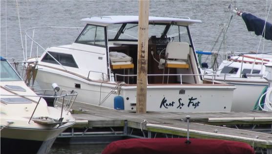

I redid my hardtop last spring because it was cracked around the perimeter where the metal trim is. Years of neglect let water get in there I guess. Anyhow the previous owner said his kids liked to jump off the hardtop into the water. So I used the durabak to cover my hardtop to be safer if my monkeys wanted to do that as well. Sometimes I wish I had just painted it white but it gets a lot of compliments with the durabak. My kids arent ready to jump so who knows. I think its very durable. The stuff has alot of rubber particles suspended in the paint and although it provides great traction for shoes, it seems uncomfortable for bare feet to me. I'm not sure if I'll do my decks and cockpit with it. Industrial is more its place in my opinion.

I really like the teak around your boat.
