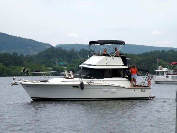

if you look at MTP'S photo you will see his forward vents are on the side of the salon above the hull joint where ours are down on the hull.
there is an arrticle somene probably has the link to a sinking of a f32 in the great lakes i think that had the vents low and i belive this is why later they were moved to the location on the side of the salon.
