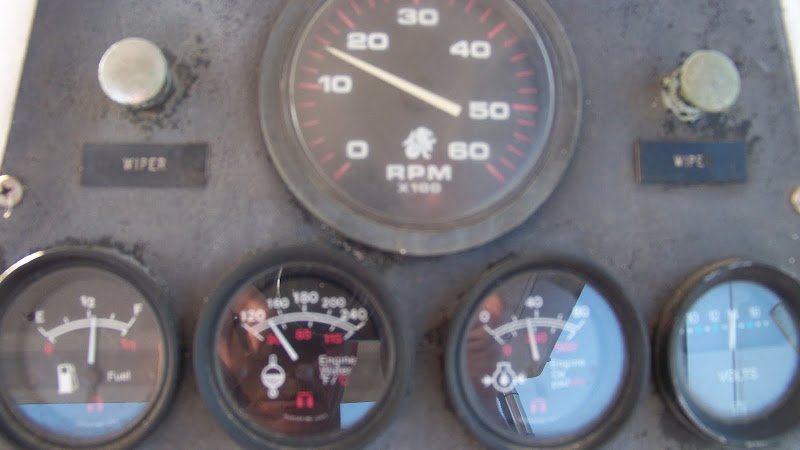

I took another trip in the river this weekend. I left Friday night, stayed until today. It was great time. I had to replace the starter on the hook. But it was two bolts not a hard job. I did take that 14x10 prop and try it. It was a for sure no go. I just do not know what to do. I tried the 14x12 and 14x10 but would not plain out. I did get too 4100 RPMS. The 16x18 prop is lugging the motor. I only get 3100 RPMS out of that prop. She does plain real good with that prop. I got up at 6am and went to the doc so I could try that 14x10 prop, I puttered to the doc at 1300 RPMS, which was a very nice little putter speed. When I put that 14x10 on there she would not do as it did on the way to the doc at 1300 RPMS. Much slower and less responsive. I am at a loss what to do now. what is the normal RPMS on plain? What is too much to where the engine can be affected? Cause at 3100 RPMS temp was runing about 165 If ill post some photos.
Weekend Photos
http://picasaweb.google.com/rodmansboat ... ekendTrip#
This is on plain
This was this morning on way to the doc to change props.

When propped right, you should be able to hit the 'max rpm' for your engine at WOT. If you can't hit max rpm, you are either over propped, or engine is tired, or trim is way off.
Idle should be around 700 - 800 RPM (maybe as low as 650 in gear), and that should give you about 3 mph.
Just getting on plane should be around 2000 RPM for your boat. Speed should be about 10-12 mph (as per the 28'er I am used to). It should start to feel 'sweet' about 2500 RPM.
Around 3000 RPM, you should be hitting near 20. If I remember correctly, my father's 28' (1969 woodie) with single 360 Chrysler did about 15mph at 2500 RPM and added 1mph per 1000 RPM added (to about 3500 RPM - we never did push the old girl beyond that).

With the 16x18 I plain out quick and at 3100 ( Which is max I get ) I am not sure how many mph I am getting with the 14x10 and 14x12 I can get 4100 RPM it will not even get on plain. It feels like the prop is spinning fast and slipping not pushing the boat very well. I will get GPS this week so I know.
I feel the reason I am not getting full RPM ( 4500 ) cause the prop is too large. I will take some photos of everything today and re-post them.
