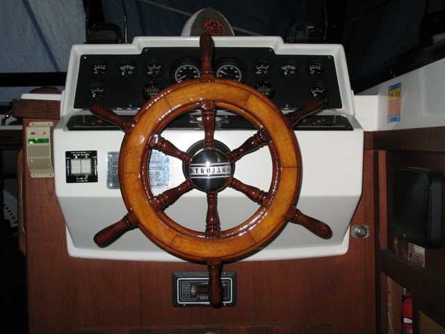

Something like this I assume? This one is off a 1969 28' Trojan Sea Skiff.

I don't care what any body else thinks, but those wheels look a whole lot better then the plain round ss wheel on both of mine, color me green.

Measure the hub carefully. I had to have some machining done before I could install the wooden wheel on mine. I have the original Syten hydraulic system, and the steering shaft is tapered. I forget the actual numbers (have them at home) but the shaft tapers down from something like 7/8" to 3/4". The hub on the wheel had a different taper (something like 3/4" down to 5/8"). Not "plug and play".
So I was faced with either machinging the wheel to grind it out, pulling the steering pump and having its shaffed machined down, or designing a custom 'converter' and having a piece of aluminum custom-machined. Didn't want to mess with the wheel (too valuable to me to let anyone get near it with a grinder and potentially mess it up) and figured the steering pump wouldn't survive removel / machining / reassembly, so I went for the custom hub converter. It fits over the existing Syten shaft taper and provides a new shaft custom cut to fit the taper on the wheel.

Found my drawings for the hub adapter... Syten steering shaft was 1" taper down to 3/4", steering wheel hub was 3/4" down to 11/16".
