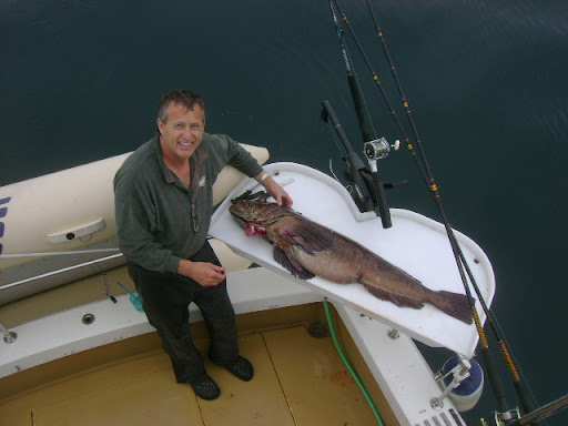

Cockpit cutting table
http://lh3.ggpht.com/_ZfOTNtsEvOY/TOB9v ... TEKING.jpg

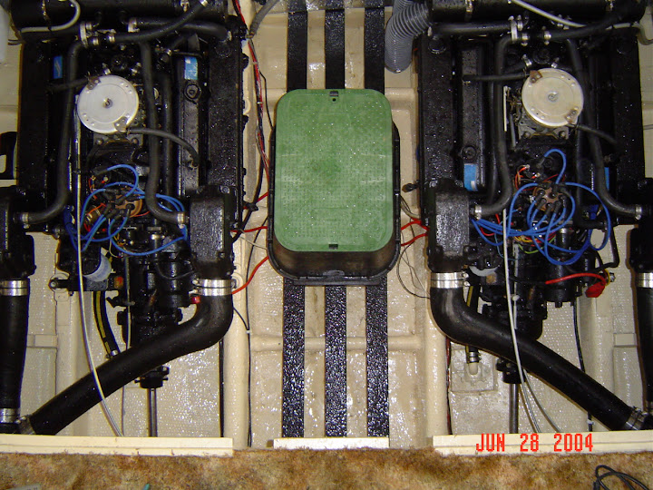

"Battery box" you can jump on. Composite underground utitlity box you can find at Home Depot or Lowe's
http://lh3.ggpht.com/_ZfOTNtsEvOY/TOVl_ ... 282%29.jpg

Nice photos, what type of paint did you use in your bilge?

Epoxy. Added silica sand for non-skid on the "catwalk" and tops of the exhaust risers, 'cause I step on them when the the hatches are open.

I like your bait table. Is it made from Starboard?
Also you mentioned that you use your exhaust manifolds as a step. Be careful doing this since it can cause exhaust leaks at the head over time.

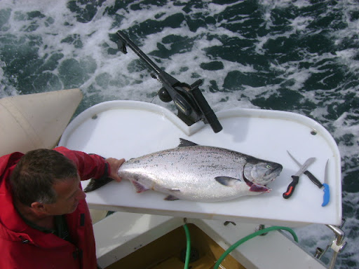

On the bait table, I can't remember the letters that designate the material. I just call it "cutting board material". It easy to work with, UV stable, weldable, and never needs painting.
I used the same stuff on my swim deck, and it still looked good after 15 years, but I just replaced the swim deck with black "Seaboard", since the topsides (rubrail down to waterline) are now black. The seabaord is supposed to be even better.

Very nicely done. I like the cutting board. I would like to know more about the material you used. Thanks.

High density polyethelyne

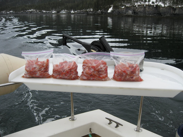

Are you catching peeled shrimp?? :lol:
