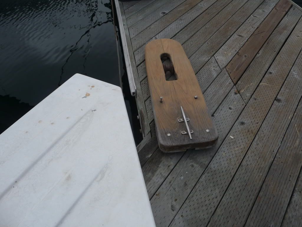

Bob, it appears the wood work has never been "treated" it is gray and grainy. A good sanding?

exactly how mine looked. A palm sander with 120 will get it in nice shape before application.

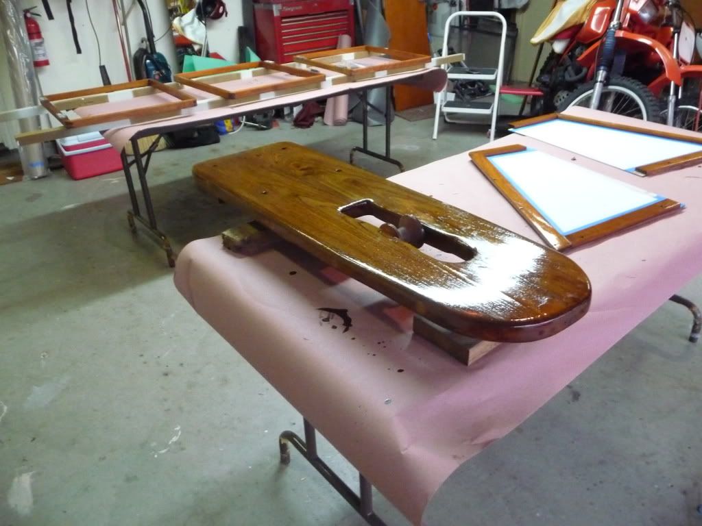

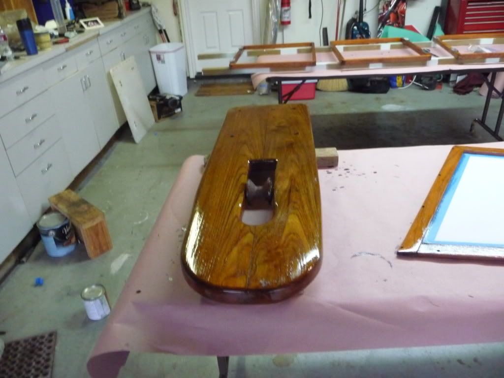

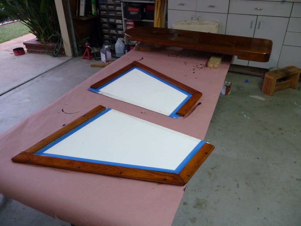

I did the following,
sand with 150, bleach and brighten with Teka or west marine two part cleaner brightener, (with port supply the westmarine brand is about 8.00 for the two part kit in quarts)
sand with 220
then 8 coats of Z - Spar polyurethane sanding with 220 between coat and a few coats every three or four months
