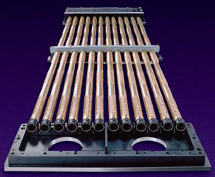

But I highly doubt You are keel cooled . A keel cooler uses coolant flowing through tubes or a exchanger that is mounted under the hull in the water . As a general rule they are not used on Planning hulls .Its a safe bet that Trojan never used them on a F32 .

Two completely different things!Diverted Income wrote:....(keel cooled) raw water cooled......

Guess I figured (wrong) 140* so it would not precipitate the river crud into the water jacket if cooler than the 180* I am wrong again. Thanks for the explanation. Still on the search for the stats though!

Re: 6.5 onan
I added keel cooler pic to my post above
