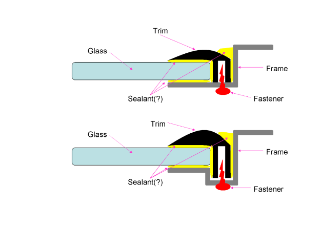

ok i'm thinking that you take out the screws on the inside and work the glass and alu. frame out from the outside ?????

best i can tell is that the screws hold the outer alu. trim on i think that it and the glass are bedded that and corrosion and time are holding tight don't want to force anything but would like to get it apart to replace the glass

Here is what things look like in cross section (one of these two variations).

Maniac,
Thanks for the drawing - that is very helpful.

thinking if you apply heat from a small torch (not holding it for to long in one spot just fanning) to soften up the old bedding as u apply some slight prying
1973 f32 twin 318's raw water cooled
The guy I had do my windshield was an old wooden boat builder/restorer. He talked to a couple of glass shops about the configuration and bought some tool from them (cost him about $50) to help cut or slice the sealant.

Great diagram. My F-32 windshileds have leaked forever. I had attempted to stem the flow by sealing from the outside (bead around the trim), but it looked bad. So, in the course of painting the boat, I removed the outer trim, breaking two windshileds in the process, bending up the trim (a machine shop straightend them), then reinstalled new glass and freshly painted trim. I reinstalled every thing and only used soft, gummy strip sealant in the center channel, and yep, they still leak.
Now, I need to remove the screws from the inside, pop the trim pieces off (which should be doable without any prior adhesive type sealant used), and reseal with something better than strip caulk.
Question is, wouldn't sealant in the center channnel (where the screws come through) suffice, as the glass is already bonded to the lip of the aluminum frame, making the screw holes the only point of entry for water?
Does anyone know how the windshields were sealed from the factory?

DAVIDLOFLAND wrote:Question is, wouldn't sealant in the center channnel (where the screws come through) suffice, as the glass is already bonded to the lip of the aluminum frame, making the screw holes the only point of entry for water?
Are you sure that water is coming in from around the glass or the screw holes? On my boat the screws are pan head so they seat well.
Any chance that your water is coming between the window frame and top of fibreglass topside? My sealant there has needed some help as water was coming in there... two places, dripping down the window frame hold down bolts to above galley head liner and also through to the inside ahead of the lower station. I used silicone sealer to seal the joint below window frame from outside.
