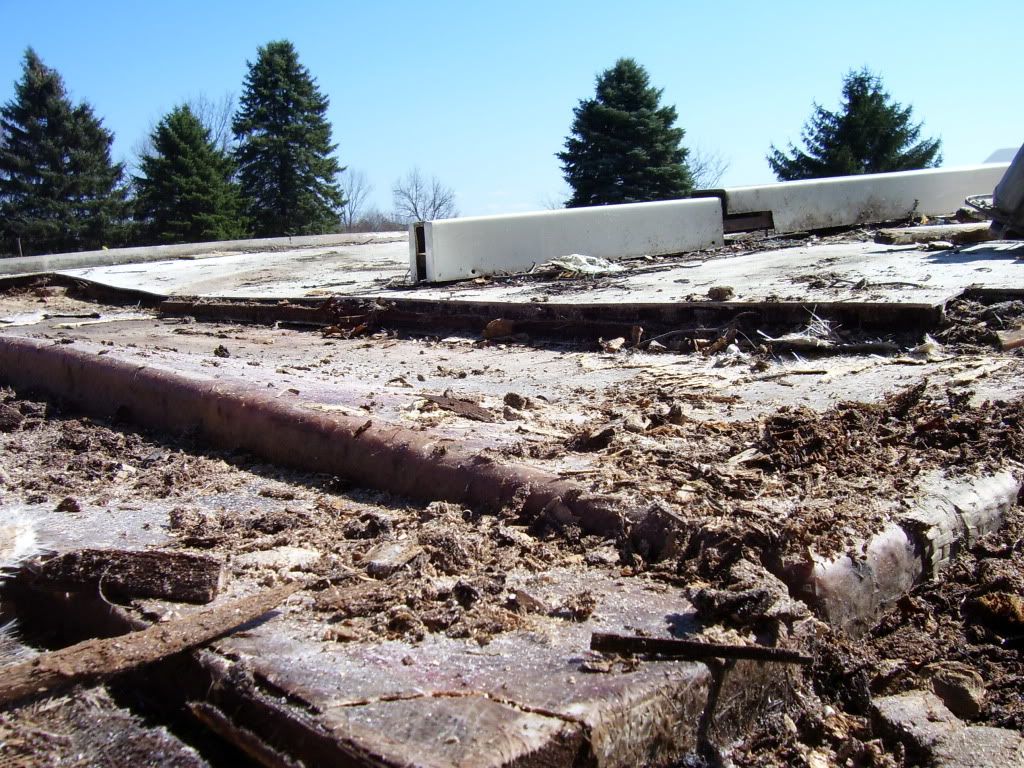

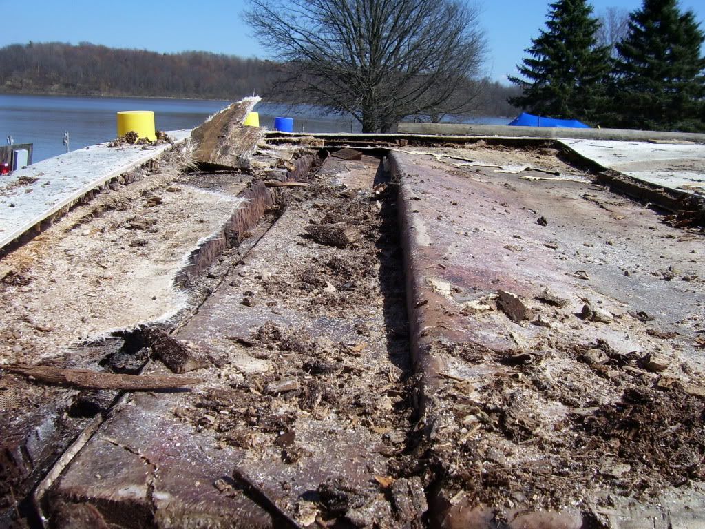

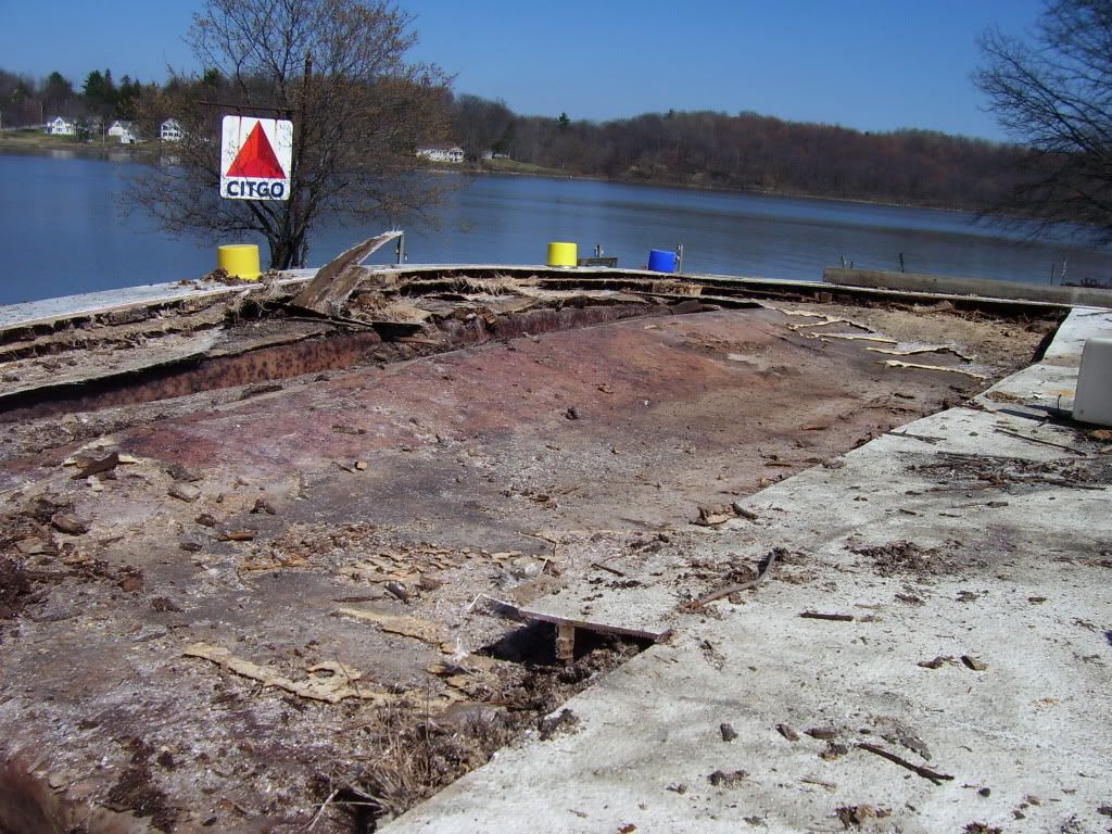

http://s1110.photobucket.com/albums/h44 ... =014-1.jpg I don't know if the pics uploaded. What I am into is the bridge deck. There was more water damage than thought. I ended up cutting a section out 8'x9'. Only 2' left in front. The deck was made of 2 layers of balsa core. Starting from the top, glass, balsa, glass, balsa, glass with another layer of glass which is the salon ceiling. The lower salon celing was randomly glued to the first layer of glass. With the weight of the water saturated balsa, it has started to sag. After all the rotted material has been removed is acn be pushed back up in place, but if not supported it comes back down. My plan is to use 2x4's to make tee's to regain contour inside salon. My delema is if I use the previous design and use two lawers of balsa, how do I lay it up so I get the crown back on top? And two, how do I get inside salon ceiling to stay up?
All input is greatly appreiciated. Rick
