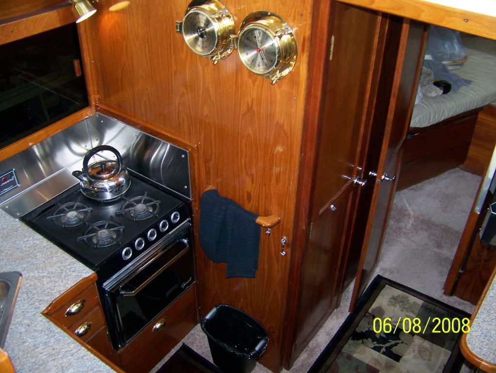

There is a lot of room in the storage area to the left of the stove. (under the sink) Perhaps you can use that area to help run a line. I'm not going to comment on where I think a safe place for an LP tank is. Parking lot of the marina maybe......

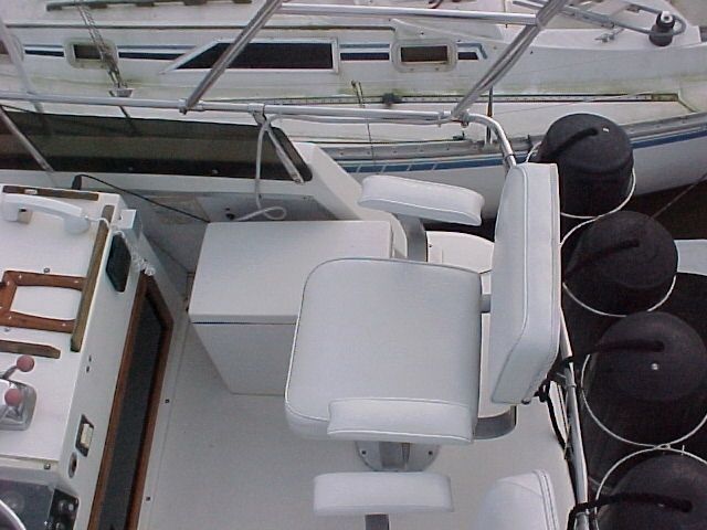

This was a stock option that Trojan used in 1978. It is on the fly bridge. As you can see the fiberglass box is located just to the right of the starboard seat. As far as venting there is none as a matter of fact Trojan made the box as air tight as possible. The tank is a horizonal tank about three gallons, The gas lines are copper and are ran in the wire chase between the side windows. There is a electronic valve that shuts the gas off at the tank that is controlled by a 12 volt switch located next to the stove. This prevents the possibility of gas leaking into the cabin when not in use. The systems seem to work very well.
http://i1123.photobucket.com/albums/l55 ... 0_1366.jpg
