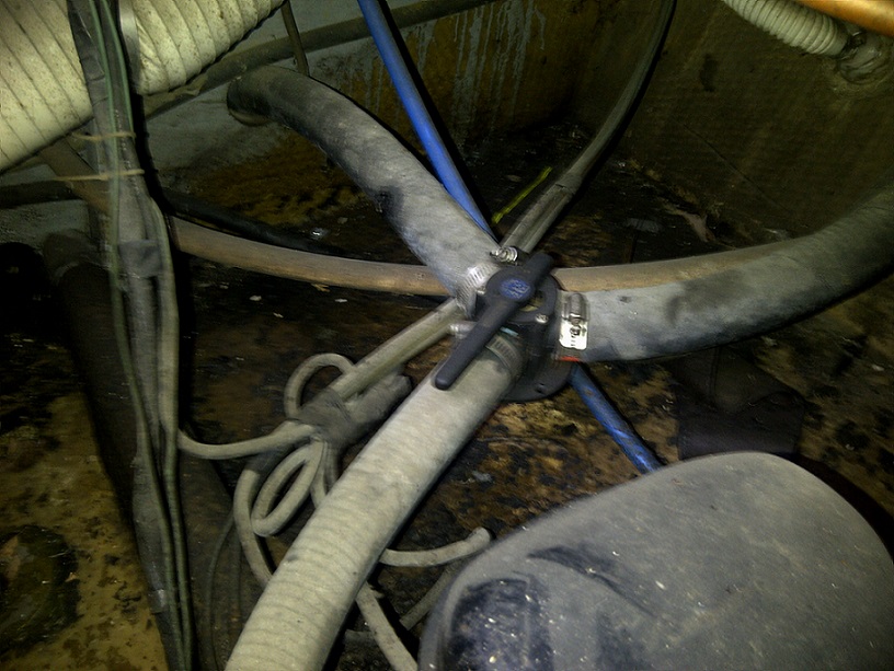

2) Short of following all the hoses to its destination which I will be doing anyways maybe someone can shed some light on 3 connection from experiance and better description
Crossroads
Crossroads

I agree with above; First pic is fridge compressor; common set up years ago. Second pic is diverter for toilet to pump into waste holding tank or overboard. Third pic is deck fitting where you would pump out the waste holding tank at a pump out station. You should be able to purchase a screw-in cover for it. Check the size, there are a few different standards. Blower; follow the white vent hose from one end to the other.
