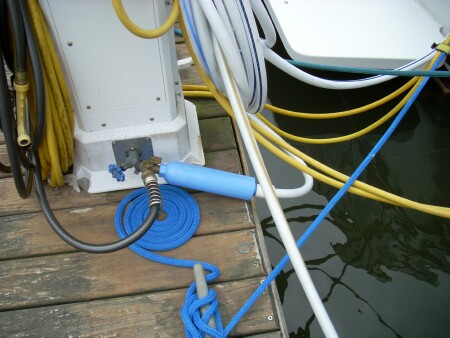

Re: Freshwater pump issue
oxblood, here is my set up and pex pipe routing from the access hatch in the aft stateroom, port side, aft. i believe that this particular vessel did not come with the shore water hook up option and it was added by the previous owner. though not a standard trojan install, it works. and works well. i have also added another pressure regulator to work in conjunction with the boat side unit. i have taken the added redundancy of adding a 'Y' valve. the valve that feeds the shore system is always turned off upon leaving the boat.
let me know, as always, if i can answer any questions you may have.
aaron
water hookup boatside
water hookup 3.jpg (30.85 KiB) Viewed 13184 times
shore source with inline filtration system purchased from an rv supply store.
water hookup 2.jpg (47.3 KiB) Viewed 13184 times
placards show what and where.  ball valve, my design, allows for tank to drain into sump for winterizing.
water hookup inside best.jpg (90.41 KiB) Viewed 13184 times

Aaron,
Thanks for the photos.
My shore water hook up looks like it was factory installed. Alas, water pressure in the shore water supply is, well low. Hook up the hose, open it to full, and I get a very slow, albeit steady stream through the galley tap. Slightly faster and higher pressure at the aft head faucet. I guess I will deal with a noisy pump for now.
Oxblood wrote:Aaron,
Cheers,
Kai
hope they assist. the low pressure from the hookup could be one of two things or a combination of both. the checkvalve in the boat could be sluggish, the water pressure at the marina could be low. i've experienced very low pressure from the shore hookup when the marina is heavily populated and many folks are washing their boats etc. the pressure is much better during the weekday when not a lot of folks are down.
let me know if i can be of further assistance.
