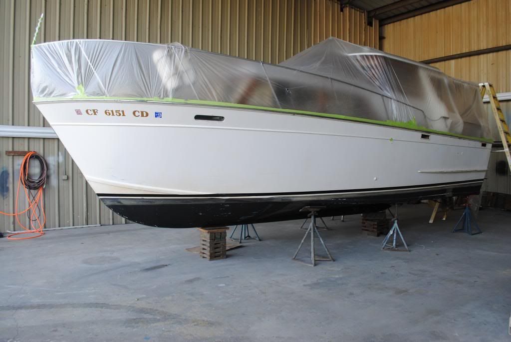

Haven't been on for a long time; busy with the boat; the old girl needed a makeover so we took her to the local boat yard; here are some pics.... it's not done yet hope to splash next week.

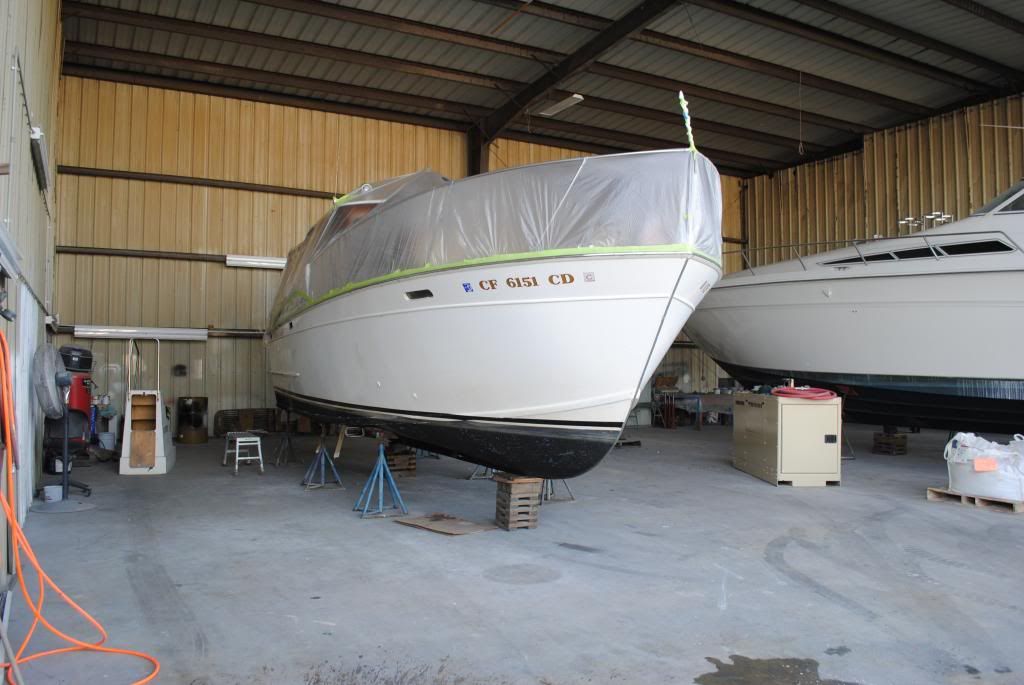

Just hauled and washed

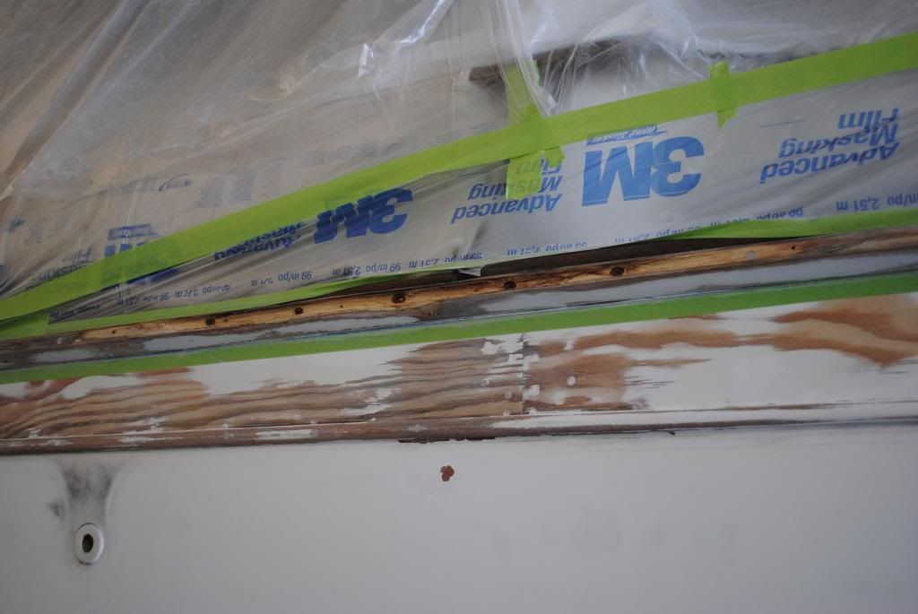

Problem area that was addressed; rot under the stainless trim.
Cleaned rot (wasn't very deep yet); applied penetrating epoxy; ready for filler.

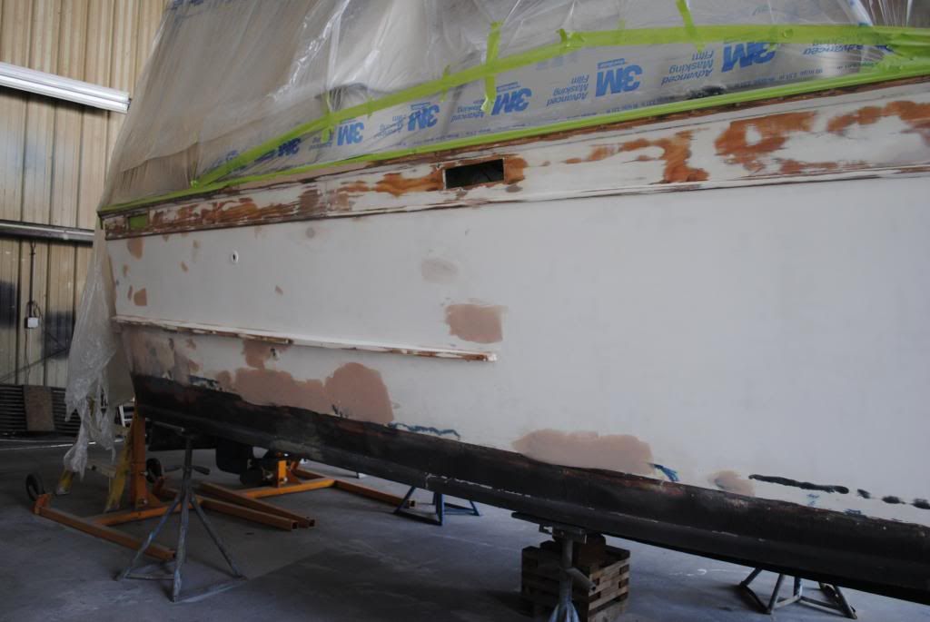

Sanding and filling

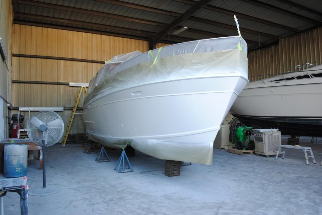

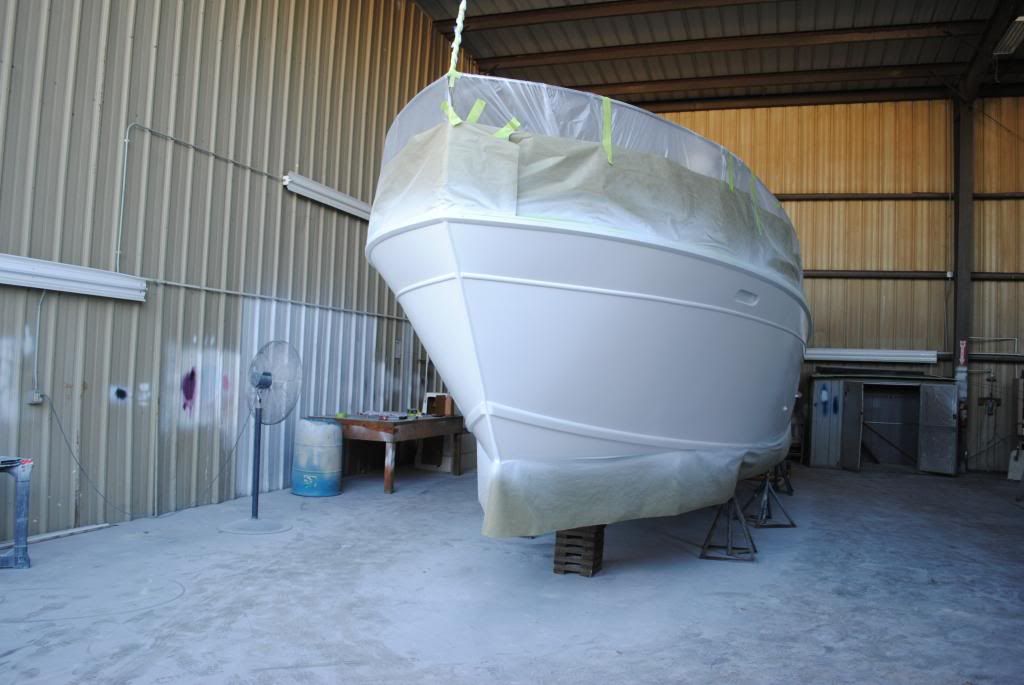

First coat of primer
Second coat of primer was applied and color went on yesterday; installing a new swim platform that I bought on craigslist and refinished. Tomorrow is stainless trim polishing all day. I'll have more pics after tomorrow.

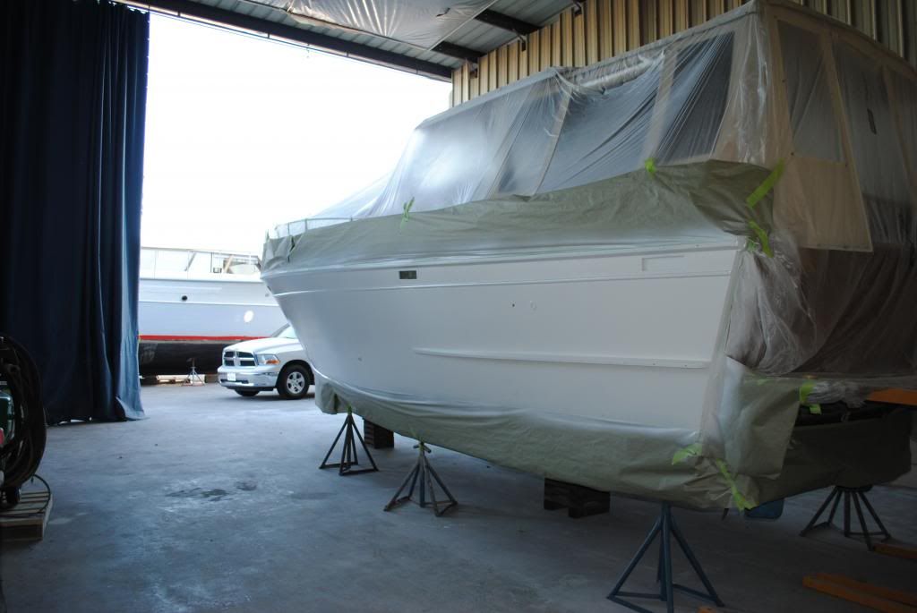

All sprayed with Awl Grip; came out awesome...
Spent all day polishing stainless trim; finally I can start putting trim back on. Not bad for a plywood boat...

Thanks; boot stripe and bottom should be done on Monday or Tuesday and then I can pull off the masking! installing all the stainless tomorrow and Saturday; repacking rudders and putting on new zincs.

Got the stainless polished and installed; new swim step with redesigned mounting brackets; she's coming along.
Can't wait to finish and see it unwrapped...
