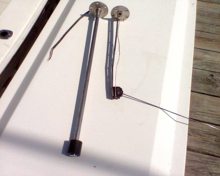

Just up graded my fuel senders to a wema unit . Finely will have fuel gauges that will be correct .Only had 1 working gauge before and it was way off when it worked . ( I always keep track of fuel used )
The new Wema is to the left .
Lots of fun to replace on a F36 :wink:

Prowlerfish - the new unit seems quite a bit longer than the unit it is replacing

rickalan35 wrote:Prowlerfish - the new unit seems quite a bit longer than the unit it is replacing
Different style, not visible off screen on old one is the float you can imagine it ends up about inline with the black thing on the new one.
Correct

Paul, on our F36, you have to take out the side cabinets and then the floor to replace the senders. Same setup on yours? If so, thats got to be about 8hr a side!

Re: Fuel senders
Same set up as yours I believe .
But it took a lot less the 8 hours . How ? I cheated . To get to the senders remove the floor panel outside of the side cabinets . This will enable you to get at the wires and screws for the senders and you can remove the old ones with some bending . But to get the new ones in bending is not a option . To get the new ones in ,I took a 3" hole saw and made a 3" hole above the sender inside the side cabinet ( slightly off due to restrictions ) and dropped the new one in .
The hardest part ? lining up the 5 holes .
On a gas boat I suggest the hole be drill before removing the sender screws
I will add some photos later (as long as I remember to take them )

Prowlerfish, I did mine last year with the same senders. My F-36 has a plywood panel directly over the fuel tanks on either side of the salon. I just removed the screws and pried it up. My interior must be different then yours.

Or the sender is more inboard on the tank . Will post the picks in a few
