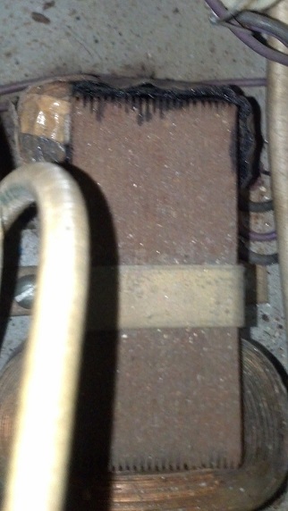

I have a Kohler gas genset, believed to be the original one, in my 69 Seavoyager. I apparently had a short in the system after having some motor work done and when the control box for the genset was reinstalled (had to be moved to get the port block out) a wire was pinched. Upon the first attempt to start the genset after this set of events a part in the control box for the Kohler "smoked" and is not inoperable. The part was a block of metal plates with what appears to be paper insulation between the plates, a voltage regulator maybe? So far I have run into wall after wall of finding someone who has this part and/or can give advice as to how to breathe life back into the old genset. Any help would be appreciated.

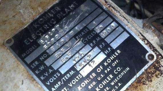

Hopefully these pictures will display correctly. One photo is of the dataplate on the genset, the others are of the part in question - hopefully you can see the one end of the part is "burnt" - this is where the smoke came from. The smoke started as soon as I fired the genset up, it was still running for a second as I shut the unit off.
You can see that one end is "burnt"
IMG_20130708_131815_142 (2).jpg (31.05 KiB) Viewed 8504 times
The part that smoked is the brownish rectangular item
IMG_20130708_131720_158 (2).jpg (74.56 KiB) Viewed 8504 times
Data Plate
Data Plate
IMG_20130708_131633_408 (2).jpg (91.27 KiB) Viewed 8504 times

Does this look like your part. If so, let me know and I'll pull it out of the controller so we can take a closer look at it.

Paul - Yes Yes Yes...that looks like the one!

OK, here's the transformer. I checked it out and found 2.5 Ohms on the skinny side and 0.3 Ohms on the big end. It did come out of a generator that worked well until its engine developed a major issue so I know that it works. The part number on this piece is 245675.
The part is yours N/C as long as all I have to do is box it up and drop it off at the UPS store around the corner from me. (or other similar arrangement) Send me a PM with the specifics and we'll get this ball rolling.
