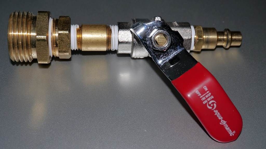

Re: Water tank, pump, and heater size
Something like this? My hose would connect to the hose end. Then my water filter would connect to the other end. Which would then feed my freshwater tank. When the tank is full I turn the handle to stop the flow of water going into my filter. Sound correct?Paul wrote:In this case, I would consider adding a potable water fitting to the boat with a tank bypass valve so that it feeds your water system directly without over pressurizing your tank.
What Paul And myself are referng to is hooking the dock water hose directly into the boats water line not the tank . The water pump will keep it from back feeding to the tank . You will need a regulator to do so like these
http://www.westmarine.com/buy/jabsco--i ... or--282228
http://www.westmarine.com/buy/shurflo-- ... --13812870
