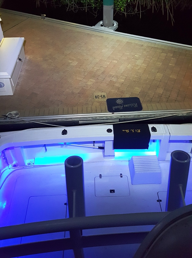

On my 12m it is all the way back behind the gas tank. It and the float switch are mounted on a aluminum bar that is secured to the top of the rudder support. Basically the bar holds them down against the bottom of the bilge, but allows them to be pulled for servicing.

I have a hatch on top of the fuel tank. You can see it in the picture dead center below the fuel fill.
