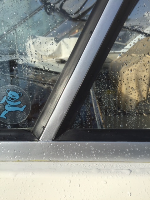

Post by BobCT »
Here's a pic. Doesn't look like much but if you still have the original trim you know how bad it looks. This is a huge improvement from what I had. It takes a long time, I would avoid ripping it ALL out if you decide to tackle this project. I would do one, maybe two windows at a time max.

Luv the sticker Bob!
