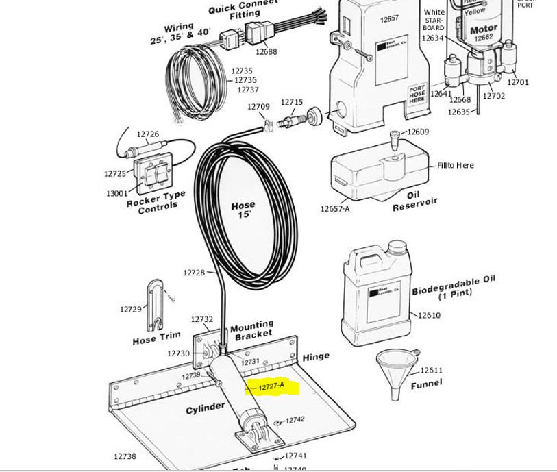

Trim Tab Spec.JPG (80.93 KiB) Viewed 17809 times

I don't see seals listed , but being the cylinders are plastic good chances they are worn too . I would just replace the cylinder(s) as they are inexpensive .
