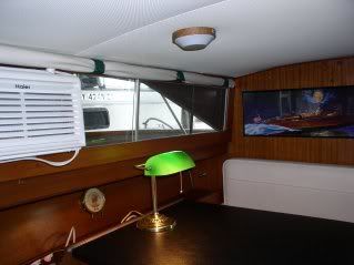

when I purchase my 71 F31 the original heat /ac unit was mounted on the wall foward of the head, and inbetween the dinette and the head. I was told this was an original unit, of course it didnt work, it was raw water fed. so for now I removed it and put in a unit. It works great , but needless to say the head is like an oven, being it vents into the head. My plan is to install a permanent marine type set up this coming spring, my setup is just to white trash for me, LOL but it does work.[img][img]http://i362.photobucket.com/albums/oo63 ... 0_0723.jpg[/img][/img]
