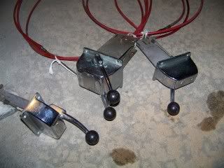

I have a set of Morse Controls (separate throttles with twin trans) with cables that I would be willing to sell cheap if anyone wants to tinker. They're old but appear to be in good condition. They came off of a Greenwich cruiser.

Thanks for the links guys. Willie, I am going to replace with the beefier Morse/Teleflex controls.
Safari- if what you have looks like Willie's photo, can you let me know? Better yet if you can post a pic of them.

I have a set of Morse controls from a Greenwich - pretty good shape w good cables. Slight pitting - should clean up fine.

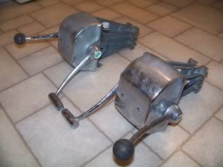

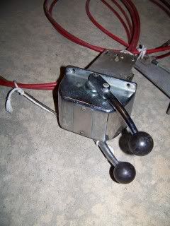

more of same.....
Some Chris Craft controls (Morse - notice chris craft logo) look a little rough, but very good mechanicals - with cables.

Safari, do you have two of the controls in the middle picture?
