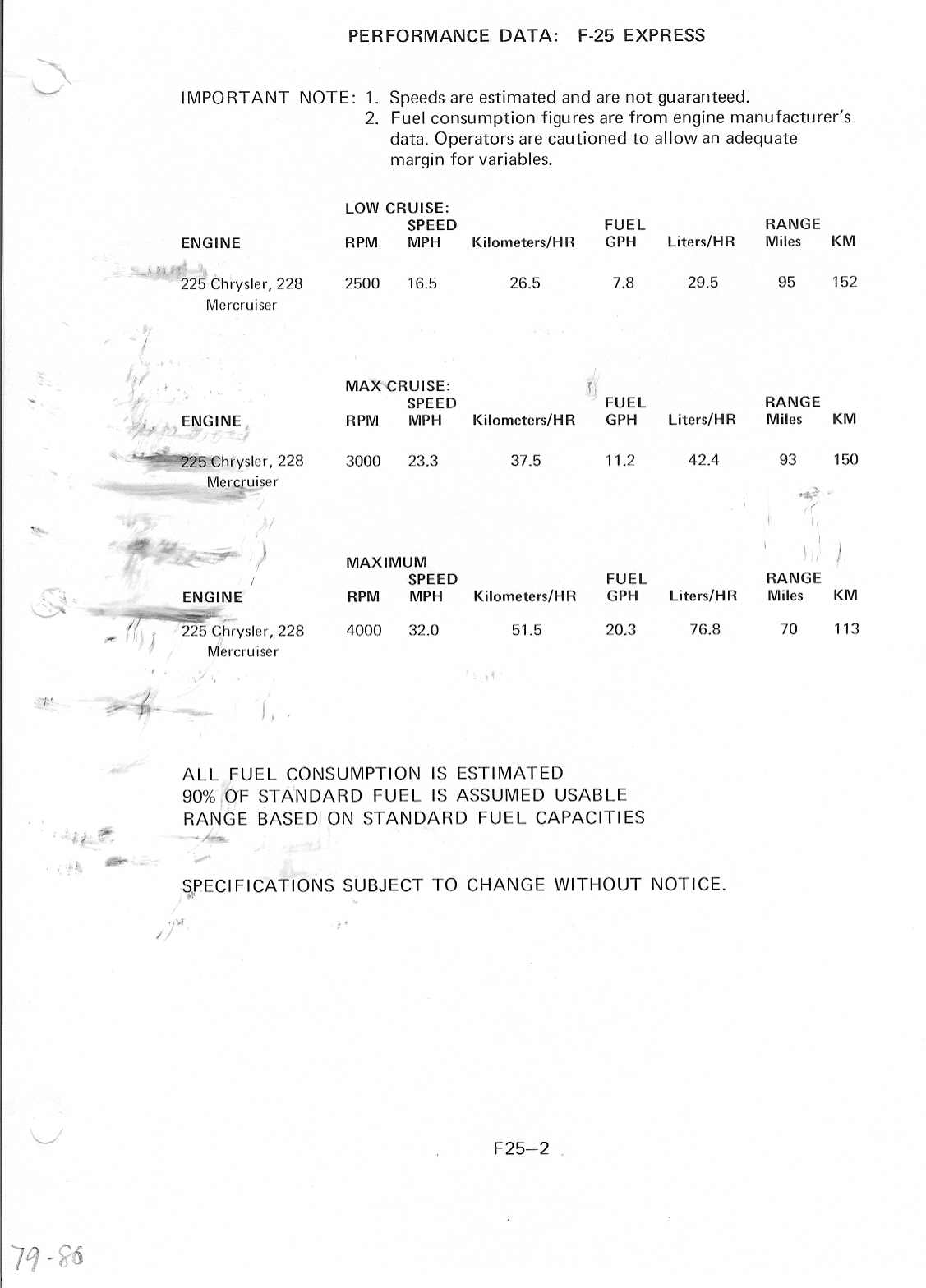

Looking at the Trojan Catalogs on this website
http://www.trojanboats.net/images/f%202 ... rmance.jpg
It states at 2500 rpm you burn 7.8 gph
at 3000 rpm 11.2 gph
and at 4000 rpm 20.3 gph
I have a 1972 F26 Trojan Express with a 318 and V-drive with a 14x11 prop and I burn pretty close to that. Of course with the price of fuel I now move at trawler speeds. At about 8 to 9 mph I running at 1800-1900 rpm's and probably burning about 4 to 5 gallons an hour.
