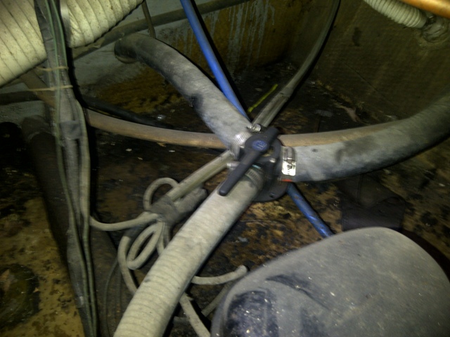

Handle
Handle

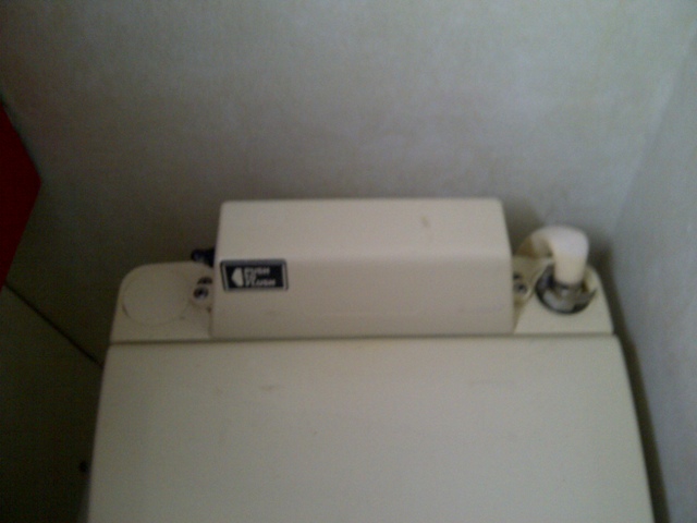

head
head
Hey prowlersfish hope this helps to identify

That valve is for the head / holding tank system . One hose should go to the the head one to the holding tank and one for overboard discharge ( not legall in most areas except off shore)
Trace the hoses and you should find your tank

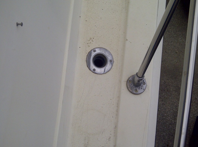

Well why kind of confused since do have waste pump out hole on starboard side so wasn't sure.
waste pump out
waste pump out

Your main hose should come from your holding tank to that valve.On one one of your hoses comiming off the vavle there should be a pump to engage for overboard discharge. the valve in the other position with allow your tank to be pumped out through the hole in your last picture either by a dock pump out station- a portable pump or a pump out boat. Should be a cover on that last pic also. good luck

In the picture of the head itself, it looks like the hose connected to the top of the toilet is pinched. I would try loosening the hose clamp and spinning the hose to get rid of the kink or consider replacing it.
