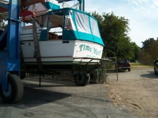

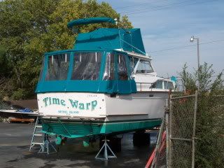

Thanks for the replys and opinions.....I had her pulled this morning and she's "on the hard" as I type this. I took it to the boat yard that had her out 2.5 years ago, the previous owner had a high opinion of this yard. I figured they knew the boat and so why change....I am amazed at the condition of her bottom and paint. I am in the CA delta with freah water. I found out that the current paint in a vinyl based bottom paint the the yard owner thinks it is best for our area. After seeing the condidtion after 2.5 years I am in full agreement and will put the same on this time. The zincs are all good too so after this time, I will be a 3 year progam......unfortunately, it is getting more and more difficult to find a yard that lets you work on your boat.....the environmental restrictions are getting crazy.......example....the run off from the power washing has to go through a filter and into a sump, then they have to take it to a hazardous waste disposal site AND provide a receipt for proof.....don't even ask about sanding and painting.......here are a couple pics....before pwr wash and after...............John

Spent the last two days buffing out the boat, 38 year old gel coat came out pretty good. New bottom paint and zincs and repaired the starboard trim tab. She splashes tomorrow morning and then a nice 1 hr ride back to my home marina.....supposed to be raining so guess I'll leave the flybridge covered and and drive from below for the 2nd time ever.....next haul will be in 3 years.....sorry for you guys that have to to on the hard for 5-6 months of the year.........stripers are running and I'll be getting out as often as I can until Thanksgiving, things will slow after that.. Don't get out much at all in the winter, to many hazards floating around. However, I have found the best place ever for a winter afternoon nap...............HappyTrails....John
