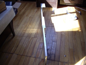

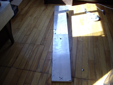

Last week, I got some aluminum plates at Metal Supermarket in Ottawa. about 7" high by 3/4" thick by 4 feet long. Times 4 for both sides of the boat. I used a non ferrous circular saw blade to "rip" the material to size. Since the access is limited, I had to cut my 4 foot lengths to 2 feet long and make a backing plate the affix both lengths together once in place. Here is a dry fit to check the bolt pattern before going in.

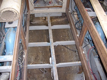

So, Step 1, empty the bilge and remove the carpet in the aft cabin...
IMGP2031 remove carpet.jpg (108.37 KiB) Viewed 8430 times
then, step 2, remove the floor!
IMGP2032 remove floor.jpg (116.12 KiB) Viewed 8430 times

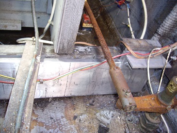

I then started work on the second side.
IMGP2056second side.jpg (113.74 KiB) Viewed 8430 times
I then hit a problem that I will have to deal with tomorrow. The second plate interferes with the fuel line on the port engine... :shock:

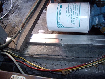

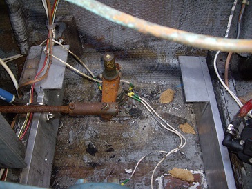

OK! I am back at the boat. Sunday, I realized that some aluminum plates did not fit. I had not counted on some unforeseen obstructions. I re-measured and modified the plates. Ordered bolts, flat washers (oversized fender type at 1-1/2 inch in diameter), lock washers and nuts to affix the plates to the stringers. the plate on the left side, in the picture below, is loosely fitted ready to bolt permanently and torqued. I just need to cut the bolts down a bit to make a tidy install. the plate on the right is in place and needs to be drilled to receive the bolts. Hopefully, all the plates will fit fine this time around... sorry for the picture quality. I thought I had everything for the day. Obviously, I forgot the camera! So, I used the phone. :?
Access is a bitch as most of the bolts are located under the engines and all the grounding wires are run inboard of the stringers... :shock: Oh well, that is part of the fun :(
I should be able to complete the work tomorrow if I survive the night! It is supposed to be 3 deg. C tonight. I will let you know how it goes tomorrow.

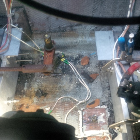

Hi Guys,

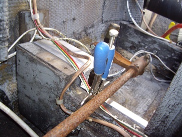

I thought I would report on the last step of the rudder support replacement. I am happy to say that the job is complete for the most part. I was able to cut the white oak to size, cut a hole for the bearing, bolt it in place and paint them with bilge paint. Again installing was difficult due to the limited access...
Some of you may notice that the spring pin is not completely in :shock: . I only had a hammer to push it in and feared that I would bend it out of shape or break it. I will need a "C" clamp to press it in properly. All I need to do now is properly attach and support the grounding wires that I removed for access.
Hopefully this thread will be helpful to someone in the same predicament.
