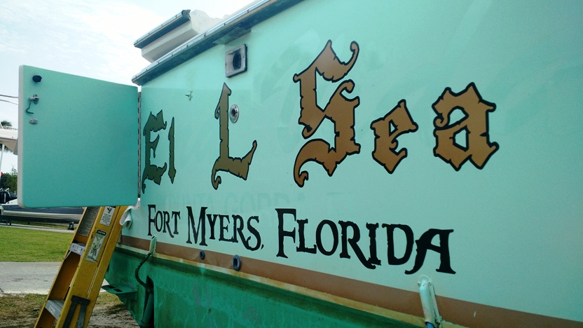

Posts: 180
Location: Fort Myers, FL
Re: 1989 Trojan 10 Meter 340 Mid cabin - Upgrade thread
Post by El L Sea »
Awesome. We just did ours when we had the bottom painted.
