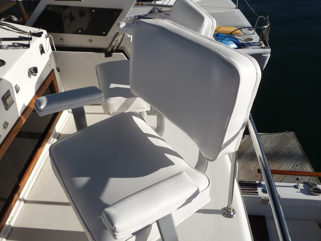

Thanks so much for the compliments. I love designing things with my own "flavor" and I'm fortunate to have resources like CAD and CNC equipment. I also have a mental disorder that impulses me to do everything myself and learn about new techniques in the process. I don't know what the term is for my disorder but I'm sure I have it! A good example of this is what I've been working on lately (shown below). I'm working on the design of the deck furniture and new arch system. I'm designing everything myself and now I'm planning on doing all the canvas and upholstery work myself which I have never done before. See what I mean? As for the cabin interior I'm not sure yet what I'm going to do. I'm trying real hard to get this boat in the water this summer for fishing and enjoying. I would like to really do the complete interior with my "flavor" but time and budget don't look good. So, I might have to postpone the interior revamp until next year because I could do that while the boat is in the water.

Also, I do all of my own canvas and upolstery. I bought a Thompson walking foot sewing machine years ago, looks just like a "Sailmaker"
it sews Sunbrella and vinyl like a pro. as you all have stated in the provious posts, do your home work and buy the right finishing products such as welting, hidem and edge banding and your projects will look great.
I also have two fold out banquet tables I set up in parallel to create one big table to sew on, it makes handling large pieces of fabric easier.
Another trick is to use a standard office stapler to "staple" your project seams together before you start to sew.
