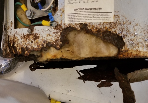

Just did my 12m Sedan last weekend. When i got it out you can see how much rust. Luckily in the Sportfisherman, the heater is under the stairs, so I just lifted it out. The good news is the Raritan replacement has a plastic outer shell.
Heater Rust.jpg (99.61 KiB) Viewed 6542 times

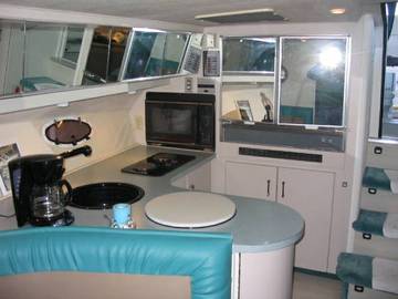

I have the express, so it's under the countertop to the left of the sink, under the coffee maker. Borrowed photo.
