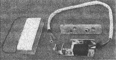

I finally found a article on how to upgrade to electronic igition with ONAN parts. Only catch is that it's $192 and you have to be a little handy to install it but should be pretty easy.
Here is the article for ya
http://www.gmcws.org/Tech/onan_electron ... ition.html
"The electronic ignition kit (EIK), shown above, is Onan P/N 160-1376 and should be available at most Cummins Dealers and/or facilities that sell and work on Onan generators"
