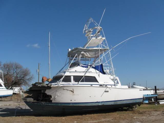

I was bidding on a 33 ft wrecked Bertram (Not sunk, dropped during hurricane recovery. A real mess of a boat but running gear good.) Anyway lost bid so will keep looking for engines. It sold for $14500.

Picture of Bertram
