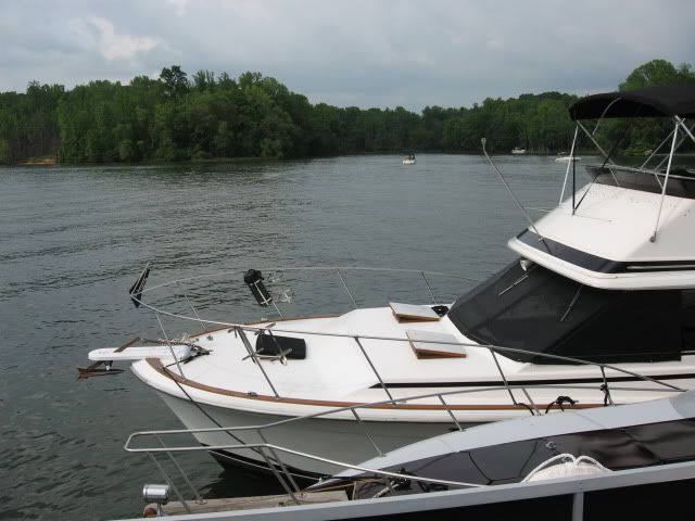

you could also use a material rather than sunbrella canvas that will let you see out its called phifertex which is what i have there are 2 versions and each filters out some of the sunlight. one up to 95%. i made mine and leave it on all the time. i can drive from the lower station with it on but i dont like to and i normally will remove it then, i also have a white vinyl cover and if it is really hot and sunny as in the summer and were anchored out for the day i will install it over the other not to double up but i have snaps on the phifertex cover that i use to snap this one on. keeps inside alot cooler. yes the phifertex darkens the interior some but depending on which version used there is still plenty of daylight even in the covered slip. it comes in various colors but i have black since my other windows are black out tinted the black front cover looks good to me and its nice being able to see out with it on. my pic shows it on the boat[img][img]http://i723.photobucket.com/albums/ww23 ... G_2237.jpg[/img]
