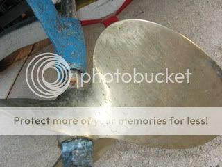

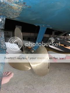

9rock wrote:That looks like a lot of prop for that boat , and the bottom looks pretty bad , what kinda speed you getting
9
\\mr elevman wrote:i would agree with jimbo my bottom looked like yours and i had it soda blasted and i picked up 3 knots at 2500rpm and got on plain sooner i was told 1.5 inch clearence minn and hears the reasion why the cavatation that comes off the outter diamiter of the prop ( the little air bubbels) is now compressed by the hull and will cut in to the hull i have 14x11 twin 318 and 4000 rpm 32 knots two gps units
The bottom I know is in need of work. I am not sure what to do with it , or just let someone else do it so I do not have to have the headache. Far as the prop, I am looking for a 14x10 used prop now.prowlersfish wrote:Get a 14x10 on it ad see what happens . Bet you will be happy when you do
