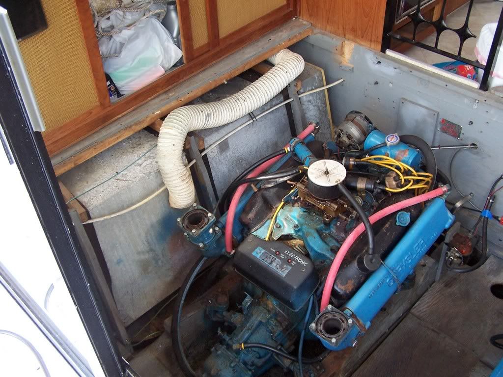

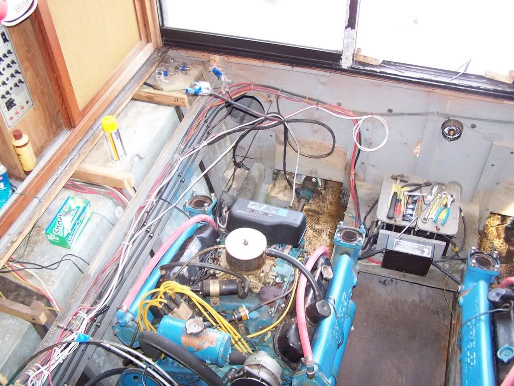

First full day today of pulling my 440's to replace them with 6BTA Cummins. Had a good friend help me and we got all the hatch & floor framing out, all the gas tank retaining structure out, the big wad of wires on the right side mostly disconnected and out of the way, the exhaust Y's and hoses out, batteries, battery boxes and paralleling switch out, all wires and hoses disconnected from the engines and some engine vibe mount lag bolts out. Someone tell me how to post pictures and I'll show you a gutted F-36.

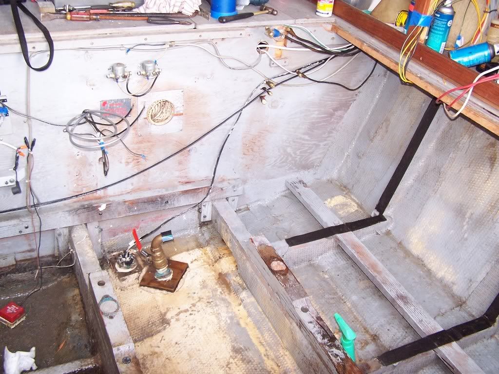

Thanks for the advice...I'll use it. Both engines are now ready to lift out. The only thing stopping me on the tanks are the 1 1/2" galv pipe filler plumbing. Could not get any of it to budge and the tanks won't slide inboard until it's removed. After I get all the gas possible out, I'll fill them with water to prevent an explosion and saw the pipes off with a Sawzall. About 1/3 of the engine mount lag bolts wrung off when I was taking them out. Those 440's were not about to slide off the beds.

Pulled both engines and fuel tanks this morning...took 30 minutes!! I had everything disconnected and out of the way and the non-moveable portion of the back sliding doors out. Alan at Sailcraft Services (the boatyard I'm in) has a steel beam that fits on his travel lift and sticks right in the back door to snake the big pieces out. Will post some more pics soon.

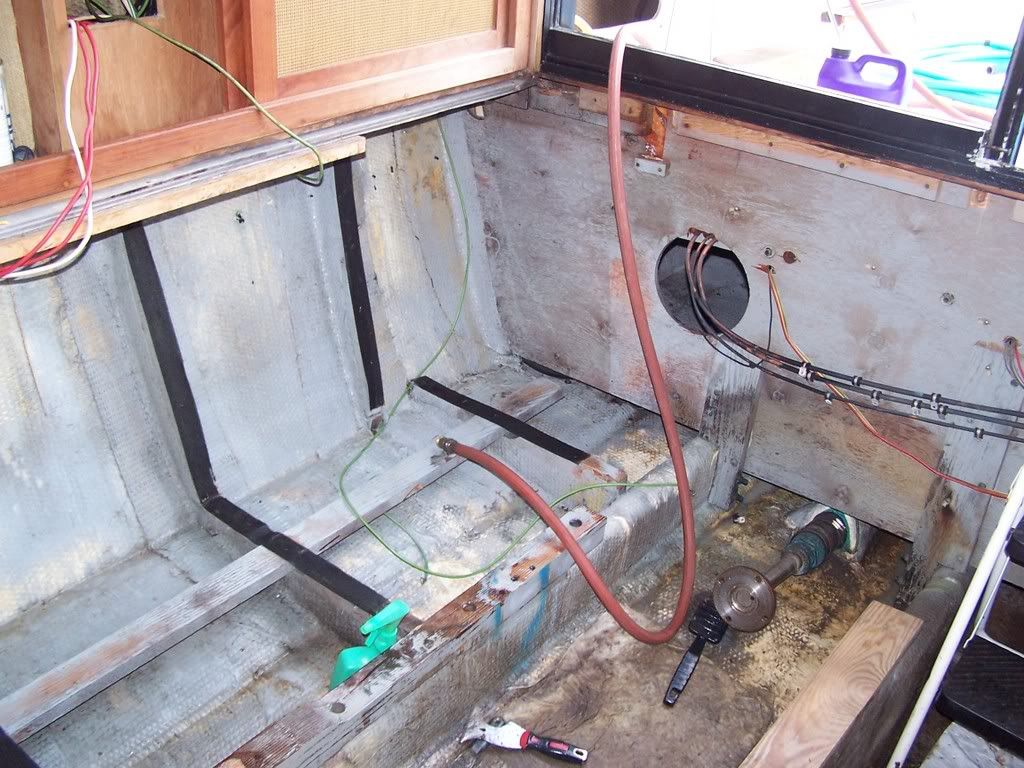

The engine seawater intakes will be replaced with 1 1/2". The scuppers between compartments in the bilge will be opened up some and cleaned out. Standing bilge water was a problem and if left unresolved will rot out stringers. Bilges are mostly cleaned...will paint next week. Have decided to replace original galvanized steel tanks with aluminum versus 50 gallon plastic tanks in several locations. Been doing a lot of measuring too. I may have to cut my shafts off and slide the Cummins back 6 inches to keep it all under the floor. Going to be a tight fit height wise. I have the old Onan loose and ready to lift out. Got to replace that rust ball also. http://i235.photobucket.com/albums/ee26 ... 0_0494.jpg http://i235.photobucket.com/albums/ee26 ... 0_0499.jpg

Been working on new engine beds this week. The forward mount on the Cummins will be 5 1/2" above the stringer...the old bed was only 2 1/2" high....had to come out. The aft mount will be notched about 1" deep into the stringer. For 27 year old wood the 2 1/2" thick fir stringers in this boat are perfect. I have not found any rot whatsoever.

New engine beds are in, old couplings are off the shafts, stuffing boxes and hoses are out for hose replacement, trim tab actuators are removed for replacement, seawater intakes and valves are removed for installing larger ones and yesterday I started cutting pieces of 1/4 inch 5052 aluminum to build my new fuel tanks out of. I'll post some more pics next week.
